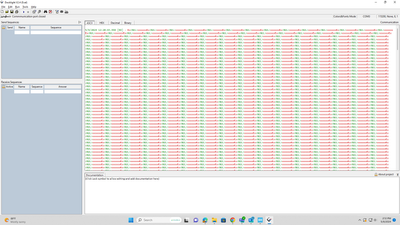

Here is the debug terminal: Screenshot (19).png

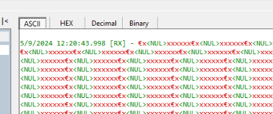

@DivyaJayan wrote:
After transmitting data, observed that the debug terminal is only receiving NUL characters.
I don't think that's what your terminal screenshot is showing?
That looks like it thinks it's receiving groups of 8 characters,AndrewNeil_1-1715244850489.png, each followed by one NUL.
What do the Hex and Binary options show?
Again, probably the commonest cause of "junk characters" on a terminal like that is wrong baud rate.
To test baud rate, transmit a single uppercase 'U' in a tight loop, and look at the timing on an oscilloscope.
