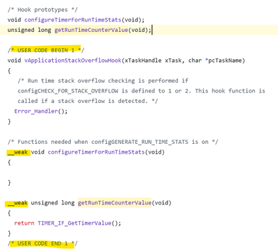

Here's a snippet of the code as generated by the IOC. All within USER CODE.
/* USER CODE BEGIN 1 */
/* Functions needed when configGENERATE_RUN_TIME_STATS is on */
__weak void configureTimerForRunTimeStats(void)
__weak unsigned long getRunTimeCounterValue(void)
return 0;
/* USER CODE END 1 */
/* USER CODE BEGIN 4 */
void vApplicationStackOverflowHook(xTaskHandle xTask, signed char *pcTaskName)
   /* Run time stack overflow checking is performed if
   configCHECK_FOR_STACK_OVERFLOW is defined to 1 or 2. This hook function is
   called if a stack overflow is detected. */
/* USER CODE END 4 */
/* USER CODE BEGIN 5 */
void vApplicationMallocFailedHook(void)
My philosophy is that if I do something normal (use this, for instance)
 I should not have to fix the code to allow it to work.  Why the other functions are defined as __weak, and this one isn't, well....  I regard it as an error, and when it's in code that ST generates, it's in code that ST ought to fix.

Actually, it does make sense if you consider that this is the provided code:
/* USER CODE END FunctionPrototypes */
/* Hook prototypes */
void configureTimerForRunTimeStats(void);
unsigned long getRunTimeCounterValue(void);
void vApplicationStackOverflowHook(xTaskHandle xTask, signed char *pcTaskName);
void vApplicationMallocFailedHook(void);
return 0;
The function prototypes are fine, as making them __weak was my mistake.
In user section 1, all the functions are properly instantiated as __weak. No problem in providing a user definition.
However, in user section 4, the function is not __weak, which produces the multiple definition errors as would be expected. It's that specific function vApplicationStackOverflowHook which needs fixing.
