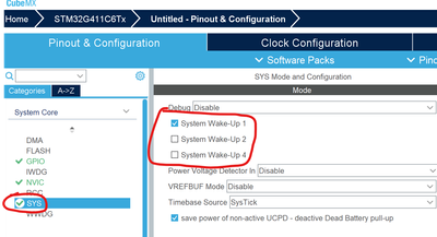

How to set the wake-up modes if the power and thermal option is not available?
Wake up options are within the SYS tab.
1 REPLY 1
