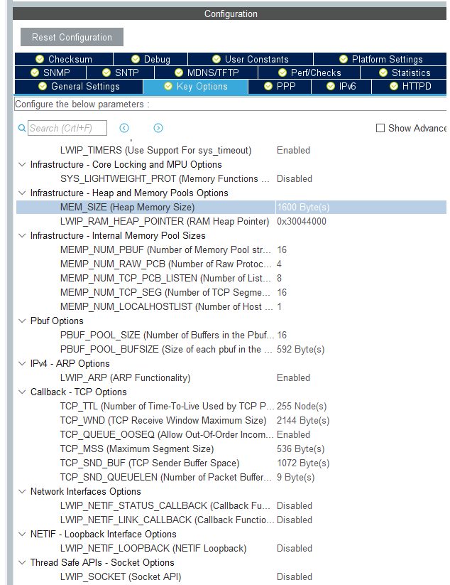

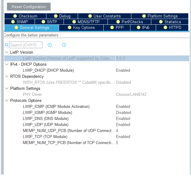

STMCubeMX lwIP configuration screenshots:
  • General Settings
  • Key Options
So, from my point of view, it looks like the board doesn't get an IP address from a router. I simply can't connect to the server because the local IP doesn't exist. I tried with two different routers and the behaviour is the same, so I doubt the problem is in the router.
As you can see I haven't written so much code. The whole set-up and lwIP configuration is generated by the Cube.
Either I am doing something wrong with the lwIP configuration, or there is some bug in the generated code.
I would really appreciate if someone could help me. If you need any additional info, I will provide it ASAP.
