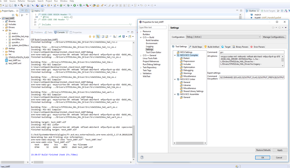

I am a new bee to STM ...tried generating the code to get the UART up for STM32L476 series discovery board...but could not compile the code in ac6 compiler as this gives following error
Error: selected processor does not support `isb 0xF' in Thumb mode
as I found we need to enter -mcpu-cortex-m3 ..but could not do so in ac6..kindly guide me and let me know how I can proceed further also any configuaration missing let me know.

when you say log file are you referring to the build conf??..as follows
14:02:58 **** Incremental Build of configuration Debug for project test_UART ****
make all
Building file: ../Src/main.c
Invoking: MCU GCC Compiler
arm-none-eabi-gcc -mthumb -mfloat-abi=soft -DUSE_HAL_DRIVER -DSTM32L476xx -I../Inc -I../Drivers/STM32L4xx_HAL_Driver/Inc -I../Drivers/STM32L4xx_HAL_Driver/Inc/Legacy -I../Drivers/CMSIS/Device/ST/STM32L4xx/Include -I../Drivers/CMSIS/Include -Os -g3 -Wall -fmessage-length=0 -ffunction-sections -c -fmessage-length=0 -MMD -MP -MF"Src/main.d" -MT"Src/main.o" -o "Src/main.o" "../Src/main.c"

I know we need -mcpu -cortex -m4 ..you are able to get in your MCU gcc compiler option...also but why I am not able to get the same..anything related to Java..initially I had some java error ...kindly let me know why this is not refelcting in my build environment??
I think if I get this through I can also buld the same

How did you include STM32L476VGTx_Flash file..how did you generate in STM cube and also include in the Inc folder??..this did not work for me..I think them -mcpu -cortex-m4 wil get included..let me know how you generated the flash file??.

Hello RShiv.1,
You'll find the STM32CubeMX.log file under <user>/.stm32cubemx folder. Otherwise if the linker file STM32L476VGTx_FLASH.ld isn't generated once you generate code through CubeMX, then your issue may be related to the JAVA version. Please check the version installed on your machine. JAVA 13 is not supported by STM32CubeMX, the max supported version is actually JAVA 11.
More information on installation requirements and procedure is in the STM32CubeMX for STM32 configuration and initialization C code generation user manual (UM1718).

Hi RShiv.1,
Backing to .log file you have shared you are using java 14 which not supported by CubeMX.
Please uninstall this version and correctly install a Java version supported by STM32CubeMX ( max java 11). This will surely solve your issue.
The use of Java Run Time Environment 1.8_45 64-bit is strongly advised to prevent the unavailability of some features such as code generation for the STM32CubeIDE toolchain.
