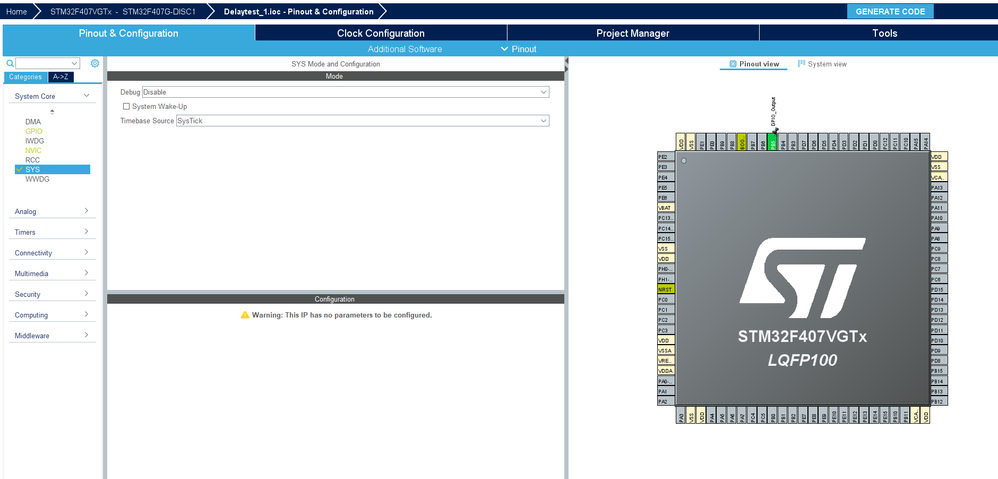

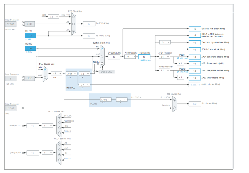

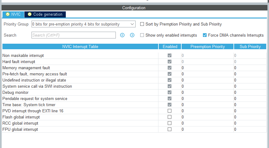

These are my configurations in CubeMX; I didn't change anything afterwards in the initialization code generated by CubeMX.

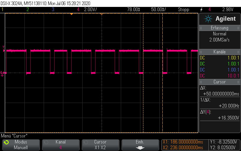

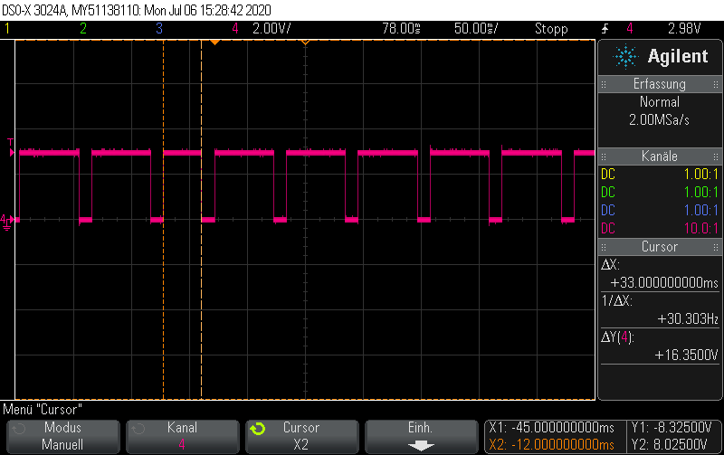

Using CubeMX I defined an output pin, wrote a simple code where I can change the on and off time of the pin and connected it to an oscilloscope.
// #1
while(1)
HAL_GPIO_WritePin(GPIOB, GPIO_PIN_5, GPIO_PIN_SET);
HAL_Delay(600);
HAL_GPIO_WritePin(GPIOB, GPIO_PIN_5, GPIO_PIN_RESET);
HAL_Delay(600);

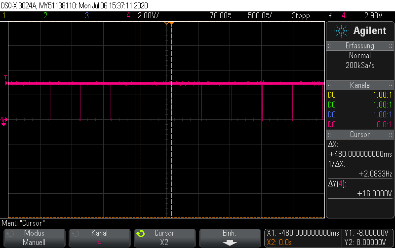

#1
0693W000001sF3qQAE.png#1: Signal stays high and has spike every 480ms

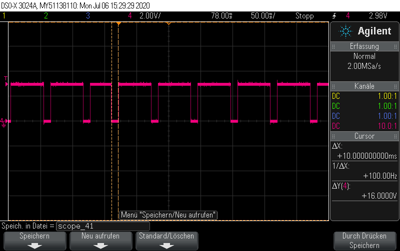

//#2
while(1)
	HAL_Delay(50);
	HAL_Delay(10);
#2: HIGH for 50ms and one impuls lasts for 33ms, LOW for 10ms as defined
I also tried the TooglePin function and also changed the clock frequency randomly, but nothing worked. Do you know where my mistakes is or what I could do in order to make HAL_Delay work properly?

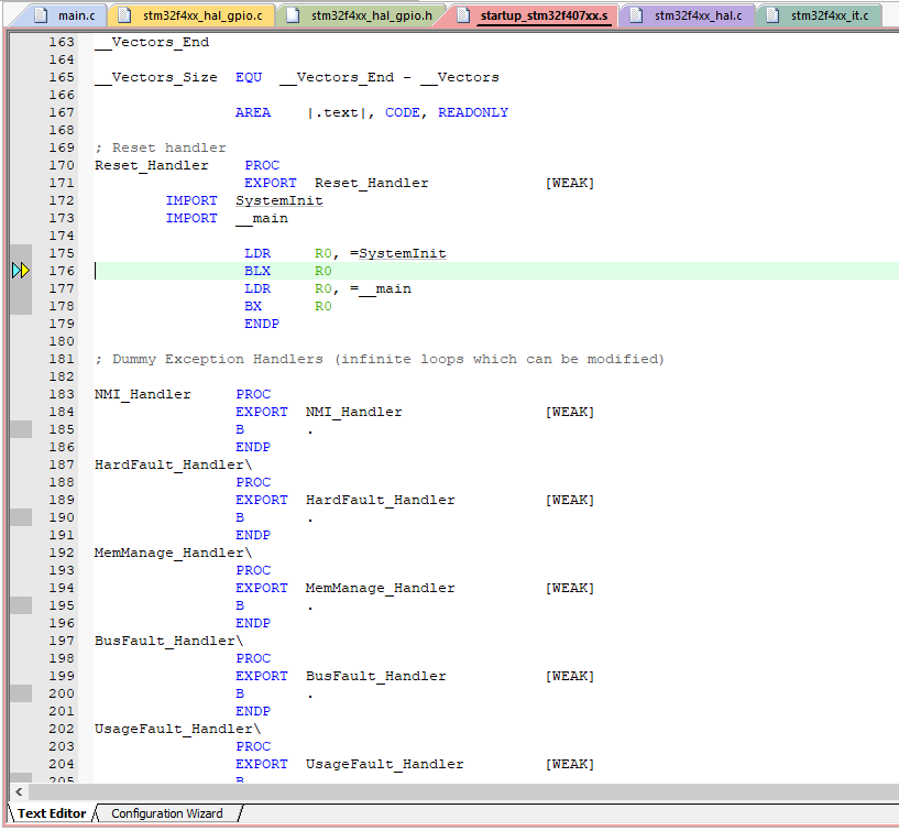

When I debugged the program using the simulator everything works as expected.
However using the STLink Debugger the program jumps to the following point somtimes:
I also noticed that the impulses that are shorter (e.g. 33ms) than the defines 50ms occur every 478ms, which is the same time periode between the two "spikes" from the first code where HAL_Delay is 600ms.
I guess the Reset_Interrupt is fired every 478ms.
Do you have any ideas how to fix this problem?

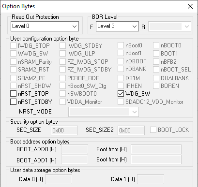

I enabled the IWDG in CubeMX and set the prescaler to 128 and the reload value to 4095. The reset occured every 16ms as expected.
So using STLink utility I checked the WDG_SW in the option bytes settings and this fixed the problem.
I am only a bit confused why the other options are grayed e.g. IWDG_STOP.
Does the WDG_SW checkbox disable both watchdogs (IWDG and WWDG) ? In the UM0892 STLink utility description they only refer to "the watchdog".
