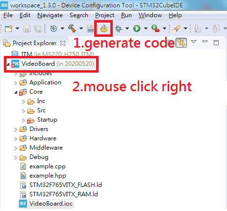

Using STM32CubeMX generate code for STM32CubeIDE and than change main.c to main.cpp, and build project will show up undefined reference to 'main' error.

The error message like as:
Core/Startup/startup_stm32f765vitx.o: In function `LoopFillZerobss':
J:/STM32PRJ/CB_ENV/MS220_F765VI/VIDEOBOARD_V9A/20200520/Debug/../Core/Startup/startup_stm32f765vitx.s:97: undefined reference to `main'
collect2.exe: error: ld returned 1 exit status
make: *** [makefile:47: VideoBoard.elf] Error 1
"make -j8 all" terminated with exit code 2. Build might be incomplete.
How can I solve this problem?

2020-05-21 7:24 PM
Hi @alister
Sorry, I misunderstood what you meant, but i solved this problem, thanks your help.
The setting steps is:
- Generate (or regenerate) code.
- Mouse click right on the project icon as:
- Select "Convert to C++" item as:
- Change main.c to main.cpp( from STM32CubeIDE rename). Don't rename from the Windows file system manually. If regenerate code need to rename again and maybe need to porting old main.cpp to new main.cpp(last rename) again.
- Build project.

2020-05-20 7:43 PM
Hi @alister
Thanks your replay.
I try to put extern "c" before the main() function but it doesn't work, the error message is the same. the code snippet following:

Do I need to modify the compilation settings?
2020-05-20 9:32 PM
I'm guessing, try declaring it only as extern "C", not defining it.
Is there a main with a C++ mangled name in the linker map file, or what does main look like there?
Are you sure you're compiling/linking the file main's in?
Check https://stackoverflow.com/questions/18137814/loopfillzerobss-has-an-undefined-reference-to-main too.
2020-05-21 12:50 AM
Hi @alister
I'm not defining it, add extern "c" before function name directly.
I don't found main.o in object.list ,because use main.cpp (i guess), the file content following:

I have read this article(in you reply) before asking this questions .
I think gcc compiler/linking cannot find the main.cpp file, so the error appears.
Using cubeMX generate *.c and *.h code. but in my project had .cpp file, And i want to call cpp function from main.c.
Therefore, I try to change main.c to main.cpp.

2020-05-21 1:50 AM
You're defining main. I'm guessing though, and I expect it'd make no difference.
//declare
extern "C"
int main(void);
//define
int main(void)
<snip>
You'd said in the post description you'd changed main.c to main.cpp. How did you do that. If it was _in_ Eclipse's Project Explorer, or if you hacked its .project file, that might be fine. But if you renamed it outside the IDE, e.g. in Windows Explorer, then the project's not going to find it and perhaps even remove it from the .project. Check the Project Explorer and rename main.c if it's there or add main.cpp if it isn't.
