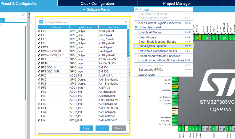

It is a bit odd, but I still can't reproduce the problem. I have loaded the attached project and when the warning window is displayed offering two options; whether to Migrate or continue, I have tried both cases and it is always the same result: There is no problem with the User Labels, they're correctly displayed in the Pinout view.
Checking the Pins/Signals Option, the User Label field is specifying the label name for each pin of the list as set by you.
0693W000005CsiQQAS.pngIt is strange that it is not working from your side, but let's see what can we do to resolve this misbehavior.
