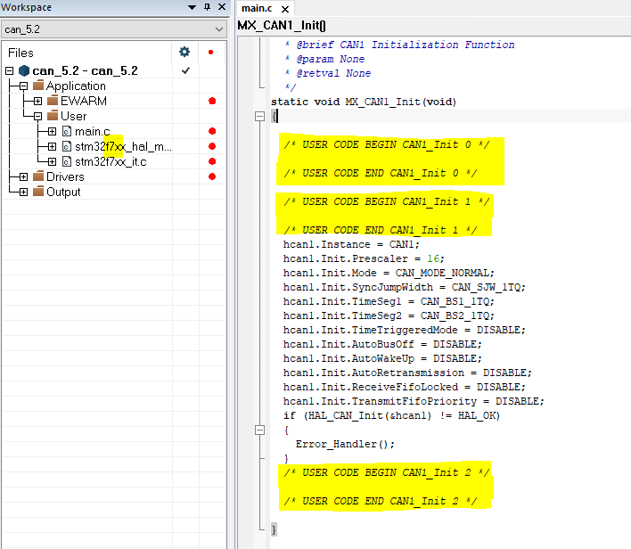

Auto-genned code in v1.14 had USER CODE blocks in MX_CAN1_Init, but after upgrading to v1.15 they are no longer there.
Where should I put my ConfigFilter and ActivateNotification calls now?

‎2019-06-04 4:47 AM
​Issue will be fixed in the next release @Community member​ .
For the moment you can uncheck the " Genearte peripheral initialization as a pair of ".c/.h" files per peripheral " under Project Manager-code Generator, you can find under main the MX_Can_Init function with the user code section ( this is a provisional solution for your case).

‎2019-06-04 2:12 AM
​Using F7 with V1.15 firmware package version (I think this's your case) - there's no problem ! no difference between V1.14 and V1.15 concerning CAN User code section.
-CubeMX 5.2.1-
