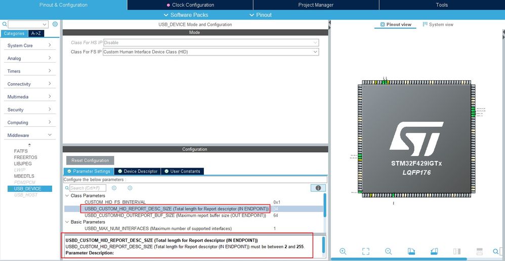

USB custom HID increase report Size more than 255 bytes?

Hello @LLYC.1​ and welcome to the STM32 Community :)
The max descriptor size is 255. This is specific to the USB protocol.
Imen

I notice the comment is incorrect. At first I thought this is to increase the size of the IN/OUT Endpoint but is is actually increasing the size of the descriptor. And the generated code is incorrect. It still left at 2.
It seems to be a bug in CubeMX.
