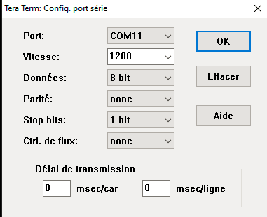

>> Case 1 that works : (no parity)
Configuration by CubeMX :
 huart2.Instance = USART2;
 huart2.Init.BaudRate = 1200;
 huart2.Init.WordLength = UART_WORDLENGTH_8B;
 huart2.Init.StopBits = UART_STOPBITS_1;
 huart2.Init.Parity = UART_PARITY_NONE;
 huart2.Init.Mode = UART_MODE_RX;
 huart2.Init.HwFlowCtl = UART_HWCONTROL_NONE;
 huart2.Init.OverSampling = UART_OVERSAMPLING_16;
 huart2.Init.OneBitSampling = UART_ONE_BIT_SAMPLE_DISABLE;
 huart2.AdvancedInit.AdvFeatureInit = UART_ADVFEATURE_NO_INIT;
 if (HAL_UART_Init(&huart2) != HAL_OK)
Teraterm configuration :
0693W00000QNIhrQAH.pngI receive the data without fault...

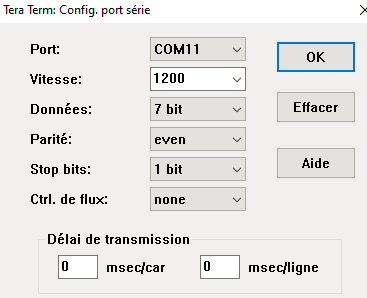

>> Case 2 not working : (even parity)
 huart2.Init.WordLength = UART_WORDLENGTH_8B; // including parity
 huart2.Init.Parity = UART_PARITY_EVEN;
0693W00000QNIiLQAX.pngHere I receive wrong things, part of the characters are correct, another incoherent
I know that the probability is high that the problem is between the keyboard and the chair but... I'm standing, without a chair! so it can come from a concern of HAL as for the TRIM which is strangely managed?
Thanks in advance
You will need to mask the parity bit off data read in such a fashion
ie int data = USART2->RDR & 0x7F; // mask down to 7-bit
8 REPLIES 8

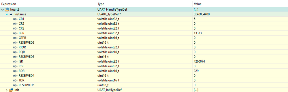

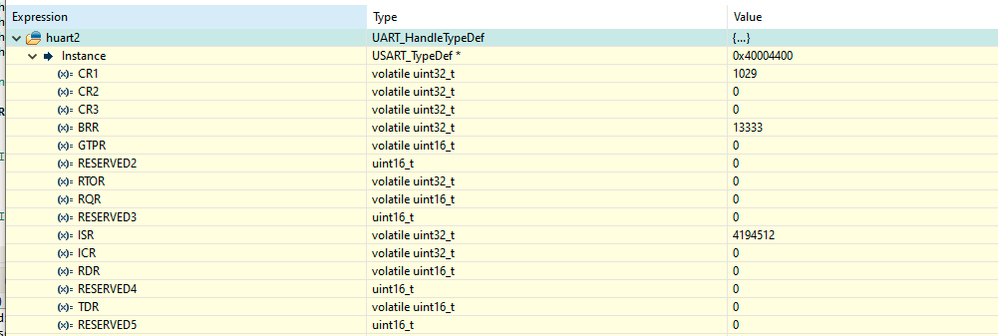

Probably failed screenshot insertion? Try through uploading, on bottom of the editor window click on the "picture" icon.
Also, read out the USART registers content and check/post.
po221
Senior
I'm afraid to understand...
When using parity do we need to manually remove the parity bit?
Here I recover the data by the DMA ; I have to loop on all my buffer to delete the 7th bit of all buffer éléments ?
I'm testing...it would correspond well to the fact that some characters pass and others do not
it's all good with less 7 bit, Thanks a lot
