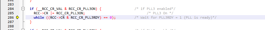

Hi all,
I have made a source code that runs fine, But after 6 months I again tried to run the same code. Now the running stuck at some point,
The code stuck at this point is shown below
0693W00000KcfPYQAZ.pngIs this error occur due to any hardware failure like oscillator /capacitor

March 15, 2022
Could be, or invalid clock settings. Put a scope on HSE to see if it's working.

March 15, 2022
The best option is measure (by osciloscope, counter, LA), that external oscilator is working. You can try PLL feed from internal HSI oscilator to check if PLL get ready.

March 17, 2022
Thanks.@TDK​  ,@ONadr.1​  , I checked with the Oscilloscope, I found some irregularities across Oscillator. So I replaced Oscillator with new one, The issue solved
