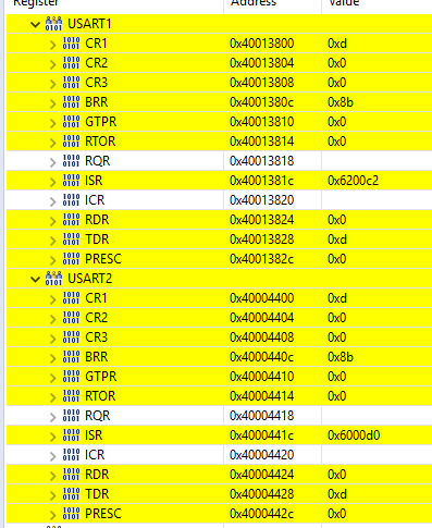

Spent most of the day debugging, to respond to the USART and GPIO Registers:
  • Both USART1(Not working) and USART2(Working) Registers have very simlar inits. They have the same nonzero values of BRR, TDR, the only nonzero value that differentiates is the ISR value, but in this case both the UARTs use polling not Interupts (so i didn't think this made a difference.
  • I checked both of the GPIO registers for USART1 and USART2, both are initialized the exact same way.0690X00000As6QIQAZ.png
waclawek.jan
ISR for USART1 indicates Framing Error, which might indicate that the receiver does work, but the incoming characters are of incorrect form - baudrate, polarity, or simply there's only some noise on the respective Rx pin.
