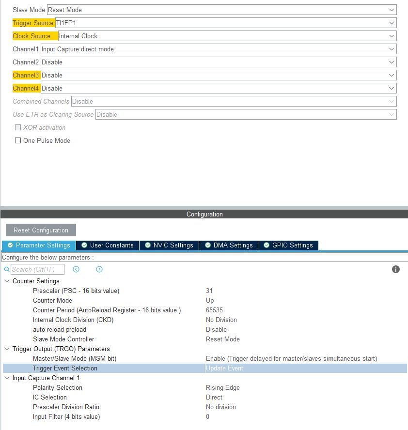

I am running Capture Mode at TIM2 channel 1. My CubeMx configuration below. I am getting CCR1 value correctly but i checked at debugger mode, CCR2 value is always 0. Thus i can't measure duty. What's the problem ?

> At F0/SPL code Timer2-Channel2 is disable too
No, it is not. It may be not apparent at the first sight, but the code above calls TIM_PWMIConfig() function which sets *both* CH1 and CH2. SPL is open source, read it.
6 REPLIES 6
waclawek.jan
In that screenshot, Channel2 shows Disable, so it does not capture.
Bahadir(Canceled)
I am trying convert legacy SPL code to HAL. It was written for F091 at 48MHz.Legacy code below.
I working on L072RB at 32Mhz.

I observe this code at debugger mode with F0 (SPL Code), there is a CCR2 value. But I observe at L0 (HAL Code) CCR2 value is 0.
Am i missing something ?
By the way JW thank you so much for your helping.
If the L0/HAL code is the one not working, why are you showing the working F0/SPL code? How will that help? Did you fix the problem that JW pointed out?
Because i just want to be ensure that converting is correct. But maybe i have a mistake. At F0/SPL code Timer2-Channel2 is disable too but there ise CCR2 value. But at L0/HAL code there is no CCR2 value. I just want to know do i have a mistake anywhere?
I also don't understand why you're so angry.

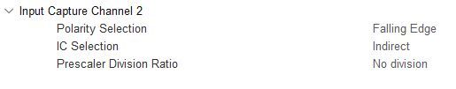

Thank you JW. I review this function and i found solution described as below. Now CCR2 is works.
