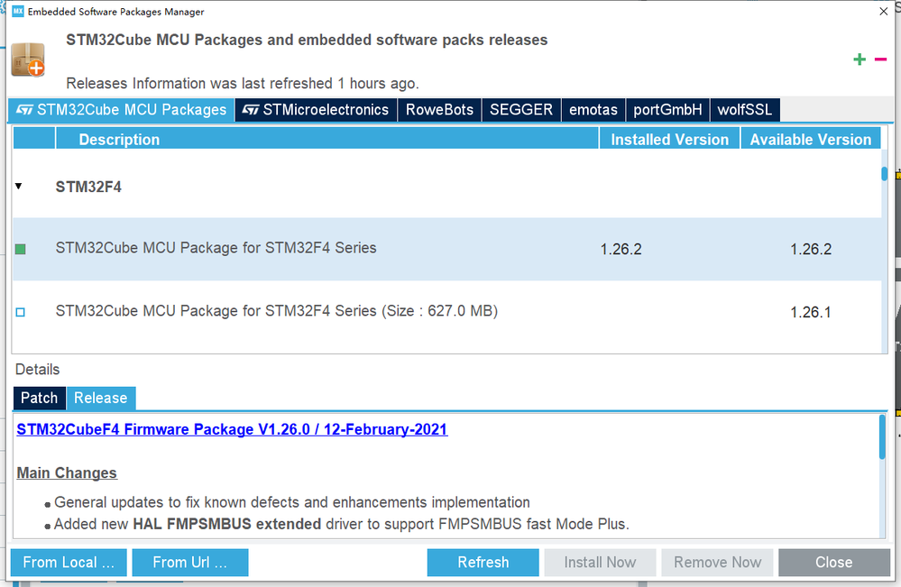

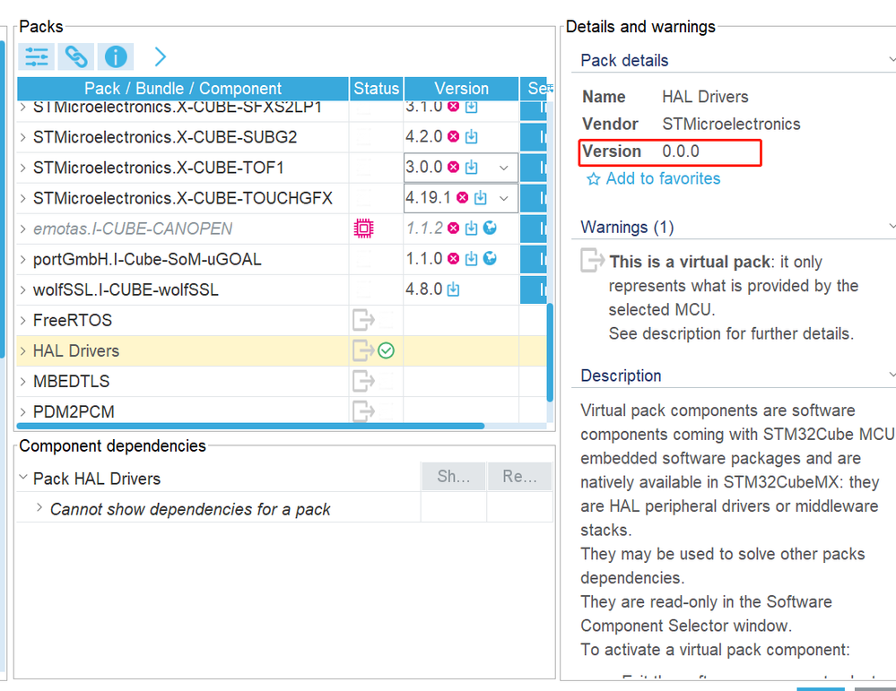

I'm using stm32CubeMX to configure my STM32F429IITx device but the generated driver doesn't work , I have to substitute by example's driver program. My board cannot call SVC handle so that my RTOS doesn't startup ,I have to use system_stm32f4xx.c‘ old driver instead (unknown version). My I2C, DMA,uart all of cannot work if I dont switch to example driver.
Here is my Cubemx capture.

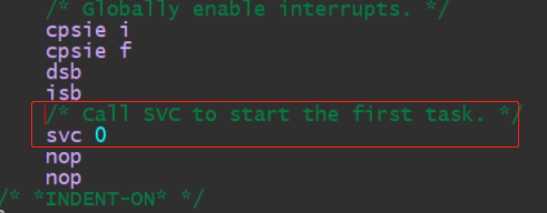

Why can't you call the SVC handle?

  1. my device stuck when call "svc 0", and rtos works well after copy system_stm32f4xx.c from example project. two system_stm32f4xx.c files has any differences?
