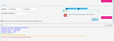

I have two questions:
1. Does the STM32U5 microcontroller support reversible RDP Level 2?

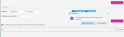

2. I have attached the steps we followed - it appears that RDP Level 2 is being unlocked, but afterward we are encountering a DEV_TARGET_NOT_HALTED.
Could someone please review the steps and helps us resolve the issue?

Hello @Gaurangthaker ,
Make sure to update the STLink version.
Please follow the steps and recommendation described in this article : How to regress from RDP level 2 to RDP level 0 on the STM32U5 series
Thanks
Imen
Gaurangthaker
Hi @Imen.D
We have followed the same procedure and thoroughly reviewed each step. Additionally, my ST-Link firmware is up to date. Please let me know if there are any other steps I should follow to resolve the issue.

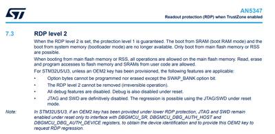

Did you try Connect Under Reset mode?
Refer to AN5347 and check the steps described in section '7 Readout protection (RDP) when TrustZone enabled'.
Thanks
