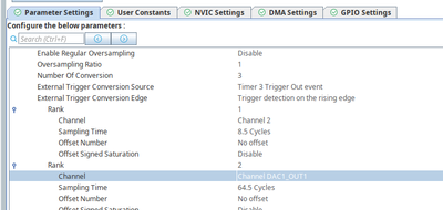

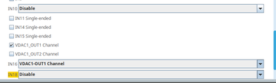

STM32H750VBT6 failed to configure ADC2 as a measurement DAC on CubeMX.
Atom336
AScha.3
You have to use/set an input of the ADC also to the internal dac: int16 here
...then can use it:
...then can use it:
