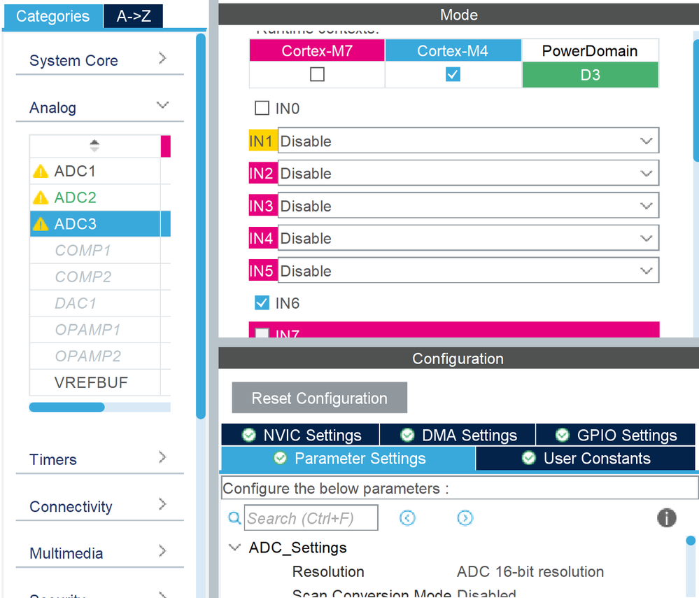

Why am I getting an ADC HAL_ERROR from the CubeIDE generated code.
  • March 14, 2022
  • 4 replies
  • 2433 views
 I’m new to STM32 development so I’ve been using the CubeIDE – Device Configuration Tool to generate most of the code, and HAL calls.
I’m using an stm32h747xih (Dual core M7 & M4 Discovery Board) and have being trying to get the ADCs to work. I’ve started with a single shot measurement.
My code is below:
HAL_ADC_Start(&hadc3);
HAL_ADC_PollForConversion(&hadc3, 5000);
sine = HAL_ADC_GetValue(&hadc3) - 512;
HAL_ADC_Stop(&hadc3);
After a lot of fault finding I’ve began to suspect the HAL_ADC_Start call. In this HAL, when this line is executed:

Show the full code, at least main.c. The ADC clock is enabled in the *_hal_msp.c file in generated code and called via HAL_ADC_Init which is called in something like MX_ADC_Init.
Since it's a dual core chip, possibly you haven't assigned the ADC peripheral to a core, so it's not initializing it. Should be an option to assign it to the M7 or M4 core in the CubeMX file.

Hi TDK,
The ADCs are assigned to the M4:
There's very little code from me. However, this is the main for M4:

Update: I've looked in the FSRs and can see the ADC3 peripheral clock is enabled (Bit 24 of AHB4ENR). So the generated code is enabling the ADC clock somewhere.
Is there a way of finding out what causes this HAL_ERROR? I'm running out of ideas of where to look.
Thanks,
Adrian.
