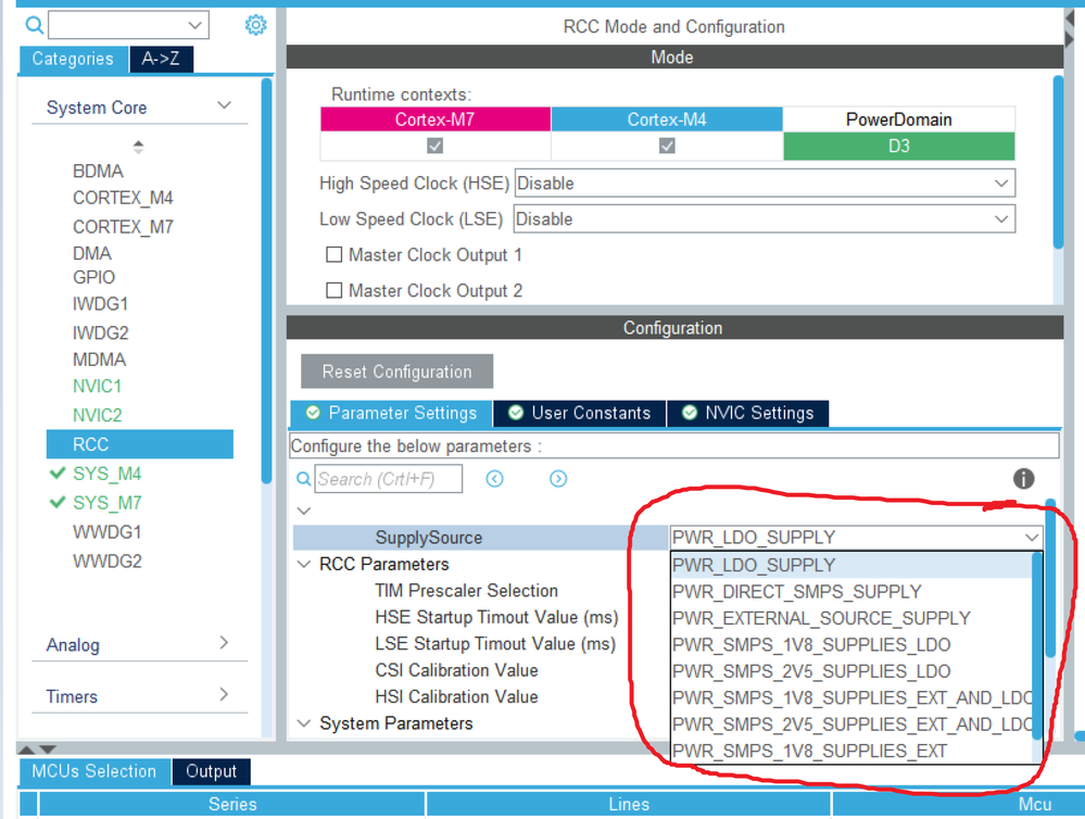

Where are the smps LDO settings in the configuration tool?
TFran.4
Configuration tool auto generated code SystemClock_Config() calls HAL_PWREx_ConfigSupply(PWR_DIRECT_SMPS_SUPPLY). For my hardware i need to use PWR_SMPS_1V8_SUPPLIES_LDO with no voltage scaling. I cannot find where to change the power supply configuration.
In RCC settings.
2 REPLIES 2
In RCC settings.
TFran.4
@TDK Thank you
