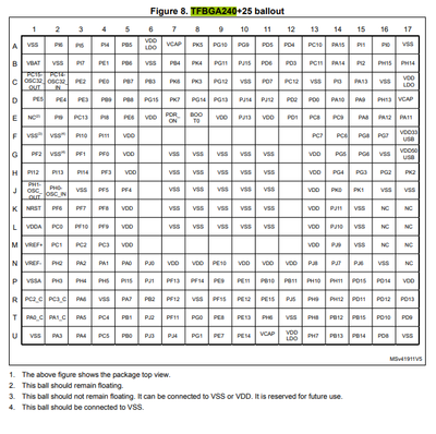

PIN NO.F1 of H750XBH6 in its datasheet differs from stm32cubemx
Tokit
In datasheet it's NC while stm32cubemx says it's VSS
It doesn't matter I think

Hello @Tokit
As you can see here:
The PIN NO.F1 is compatible on datasheet (DS12556Rev7) and CubeMX configuration. I think you are using an old revision that has been updated.
Best Regards.

Peter BENSCH
@Tokit some additional information: the data sheet from which you took the screenshot is the old rev 6. The screenshot from @STTwo-32 is from the newer and corrected rev 7.
Regards
/Peter
Thanks.Datasheet on semiee is outdated
