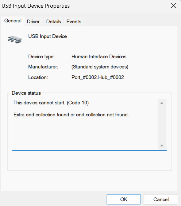

I am trying to test a CustomHID from the STMCubeMX code and the project does not seem to work as intended.
When I use the HID Standalone example for the STMH735G Dev Kit the project works as intended however when I try to set it up with the CustomHID windows gives this error. I changed the clocks to match the HID Standalone project with a max clock of 520mhz.
Wondering what I am doing wrong or if there is some setting that needs to be modified for this to work properly. Looks like everything is setup and should work already but doesn't

‎2023-02-22 7:58 PM
I resolved the issue,
the project with the default descriptor does not actually set anything up.
I followed this video for setting up the USB device
https://www.youtube.com/watch?v=3JGRt3BFYrM&ab_channel=STMicroelectronics

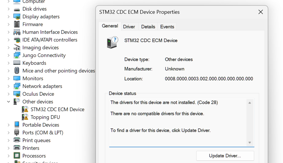

‎2023-02-22 7:35 PM
Hi Imen,
The clocks are identical to the ready to use application and my application.
I increased the heap size to 0x1000 as suggested and this still did not resolve the issue.
still receive code error 10
when attempting the CDC example for AzureRtos
I get this, I dono if this is helpful information to resolving this.
‎2023-02-22 7:58 PM
