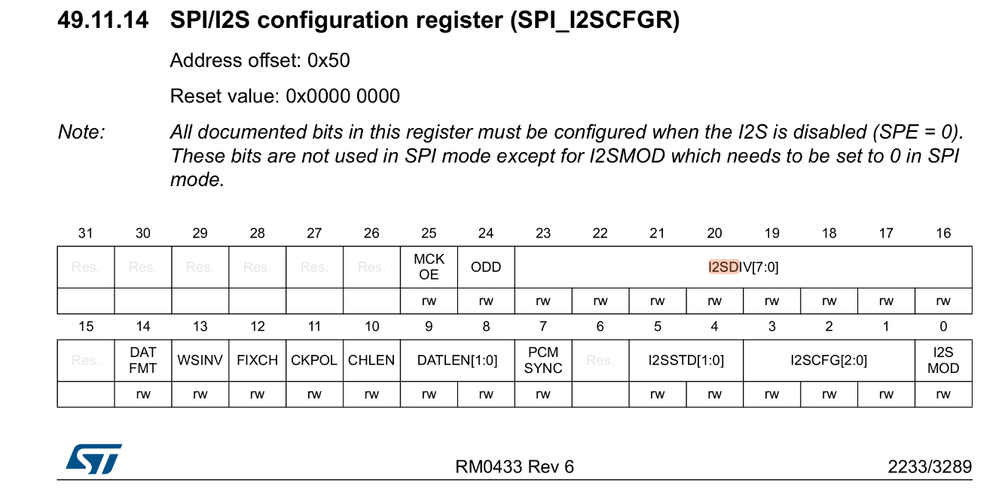

Is there a way to go lower than 8kHz sampling Audio Frequency on I2S?
If so, how would I go about it manually adding in the code?

Try picking a close multiple and fiddle the values in the PLL or prescalers

There is 8-bits divider:
