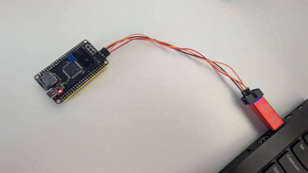

hello team,
I am facing a debug connection issue with STM32H723VGTx using STM32CubeIDE and ST-LINK.
Issue details:
  • MCU: STM32H723VGTx
  • Debug tool: ST-LINK (OpenOCD via STM32CubeIDE)
  • Interface: SWD
  • Reset mode: Software reset
  • SWD frequency: 50 kHz
Observed behavior:
  • ST-LINK connects successfully.
  • Cortex-M7 core is detected correctly.
  • GDB server starts, but the debug session fails during memory access.
Error message:
Error: Failed to read memory at 0x5c001000 Error: auto_probe failed Error: Connect failed
Additional observations:
  • Target voltage reported by ST-LINK is ~2.8 V.
  • I already tried:
    • Lowering SWD frequency
    • Using software reset
    • Adding monitor gdb_memory_map disable in debug startup commands
    • Halting on reset
  • Issue still persists.
Request:
Could you please confirm:
  1. Whether this memory address (0x5C001000) access failure is related to power / AXI-D2 domain / debug configuration on STM32H723.
  2. If there are any recommended debug settings or patches for STM32H7 devices under these conditions.
  3. Whether minimum voltage requirements can affect debug access to AXI/D2 memory during GDB connection.
   if possible can we connect
Regards,

AScha.3
February 9, 2026
Should work with 4 MHz , if your connections ok and not more than 20 cm about.
If not working at 4M, something is wrong.
+ > voltage reported by ST-LINK is ~2.8 V.
Thats very low...you have powered target at 3v3 ?
Can you show a pic from your setup with st-link + target ?

manoj3Author
February 10, 2026
hello pavel A,
as you asked photo i have sent.
your saying software problem i am using 14.1 do i need to use other version can you please suggest which one i need to use.
tell me how to over come this issue. and do i need to solder NRST button on board?
manoj3Author
February 10, 2026
gbm
February 10, 2026
The debug probe is definitely NOT an ST-Link. It's firmware is illegal, very likely outdated and the attempt to update it from ST software should fail because it's illegal.
Get a real ST-Link or switch to CMSIS-DAP debug interface.

Andrew Neil
March 25, 2026
You've marked this as solved - so it's not surprising you're getting no new replies.
If it's not actually solved, then you need to un-mark the solution.
As @gbm said, what you're using is not a genuine ST-Link, so there's no guarantee that it will work properly - or even at all.
You need to get a genuine ST-Link, from an Approved ST Distributor.
