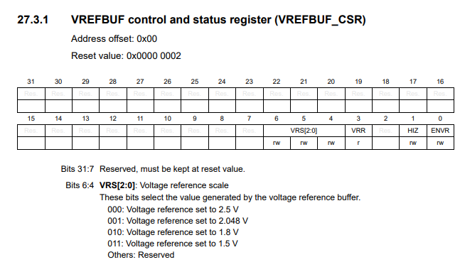

While you guys are looking into fixing that, maybe also have a look on this other bug:
Selecting 2.5V reference in cubeMx gives out this code in stm32h7xx_hal_msp.c, which seems correct:
HAL_SYSCFG_VREFBUF_VoltageScalingConfig(SYSCFG_VREFBUF_VOLTAGE_SCALE0);
but then one can see this weird re-shuffling in stm32h7xx_hal.h:
#define SYSCFG_VREFBUF_VOLTAGE_SCALE0  VREFBUF_CSR_VRS_OUT2  /*!< Voltage reference scale 0 (VREF_OUT2) */
 #define SYSCFG_VREFBUF_VOLTAGE_SCALE1  VREFBUF_CSR_VRS_OUT1  /*!< Voltage reference scale 1 (VREF_OUT1) */
 #define SYSCFG_VREFBUF_VOLTAGE_SCALE2  VREFBUF_CSR_VRS_OUT4  /*!< Voltage reference scale 2 (VREF_OUT4) */
 #define SYSCFG_VREFBUF_VOLTAGE_SCALE3  VREFBUF_CSR_VRS_OUT3  /*!< Voltage reference scale 3 (VREF_OUT3) */
#define VREFBUF_CSR_VRS_OUT1        ((uint32_t)0x00000000)                     /*!<Voltage reference VREF_OUT1     */
#define VREFBUF_CSR_VRS_OUT2_Pos    (4U)
#define VREFBUF_CSR_VRS_OUT2_Msk    (0x1UL << VREFBUF_CSR_VRS_OUT2_Pos)        /*!< 0x00000010 */
#define VREFBUF_CSR_VRS_OUT2        VREFBUF_CSR_VRS_OUT2_Msk                   /*!<Voltage reference VREF_OUT2     */
#define VREFBUF_CSR_VRS_OUT3_Pos    (5U)
#define VREFBUF_CSR_VRS_OUT3_Msk    (0x1UL << VREFBUF_CSR_VRS_OUT3_Pos)        /*!< 0x00000020 */
#define VREFBUF_CSR_VRS_OUT3        VREFBUF_CSR_VRS_OUT3_Msk                   /*!<Voltage reference VREF_OUT3     */
#define VREFBUF_CSR_VRS_OUT4_Pos    (4U)
#define VREFBUF_CSR_VRS_OUT4_Msk    (0x3UL << VREFBUF_CSR_VRS_OUT4_Pos)        /*!< 0x00000030 */
#define VREFBUF_CSR_VRS_OUT4        VREFBUF_CSR_VRS_OUT4_Msk                   /*!<Voltage reference VREF_OUT4     */
But according to the manual there should be no re-shuffling:
