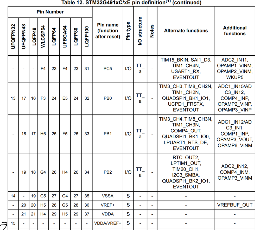

Hello @Osto​,
  1. Could you please precise full product package? Is it STM32G491 UK ? Because I can see for example in UFQFPN32 package, the voltage reference buffer is not available and must be kept disabled. As referenced in RM0440 section 23.1 Introduction : When the VREF+ pin is double-bonded with VDDA pin in a package, the voltage reference buffer is not available and must be kept disabled (refer to datasheet for packages pinout description).0693W00000Y7PfsQAF.png

Its with STM32G491RET6. So, there is a VREF Pin on package.
