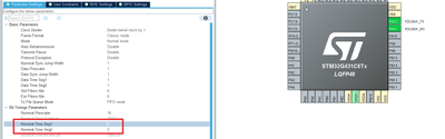

STM32G4: STM32CubeMX bug for FDCAN?
CTapp.1
Senior III
I am seeing a similar issue in STM32CubeIDE v1.15.1 when trying to configure the FDCAN for the STM32G432KB - I am not able to set "Nominal Time Seg1" or  "Nominal Time Seg2" to '1'.

Hello @CTapp.1 ,
First, there is no STM32G432 device but STM32G431
Second, this is a thread was originally created from https://community.st.com/t5/stm32cubemx-mcus/stm32cubemx-bug-for-fdcan/td-p/636894 as the issue persists on CubeMx 6.12 with STM32G431 device was fixed for H5 product.
Internal ticket 185818 has been opened to fix the issue.

CTapp.1
Senior III
Thanks - I look forward to the fix.

FYI,
Issue fixed in CubeMX 6.13.0.
