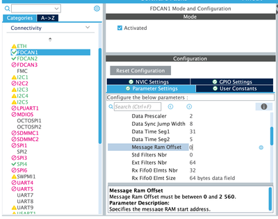

Hello @Mahmoud Ben Romdhane , I know this is marked resolved, but we are running into the same issue on STM32CubeMX v6.16.0 for a project using an STM32H723VGTx. There is no place in the GUI to input the MessageRAMOffset and the generated functions do not include an appropriate offset, so it appears this is still an outstanding issue, at least for the H7 processor family.

Hello @ricky-fleet ,
The Message Ram Offset is well implemented on FDCAN1.
Thanks.
Mahmoud
Thank you for clarification @Mahmoud Ben Romdhane, I manually updated my H7 software package in CubeMX and can see the setting now! (Not sure exactly when it was added, but it definitely appears in CubeMX version 6.16.0 with STM32H7 version 1.12.1).

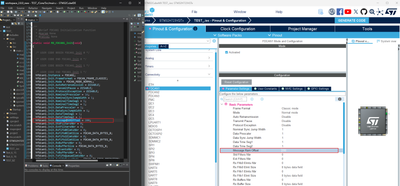

Hello @Mahmoud Ben Romdhane,
I have the same issue on H5 series. It is possible to correct STM32CubeMX for all series with the same FDCAN module please ?
I use STM32CubeMX 6.16.1 with 1.5.1 MCU package for STM32H5 series.
