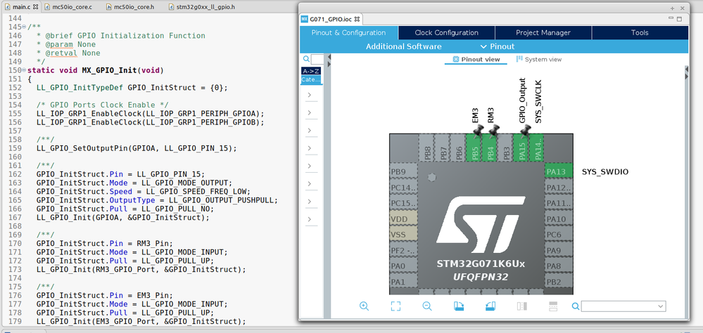

PB4, PB5, PA15 seems disconnected from IO matrix.
Same behavior repeat across all MCU I have on boards.
Measured voltage on pin they appear floating
PA15 1.39V
PB4 2.33V
PB5 0.81V
Forcing register to output don't change pin voltage, forcing pin to VSS or VDD don't change input register stuck at 0.

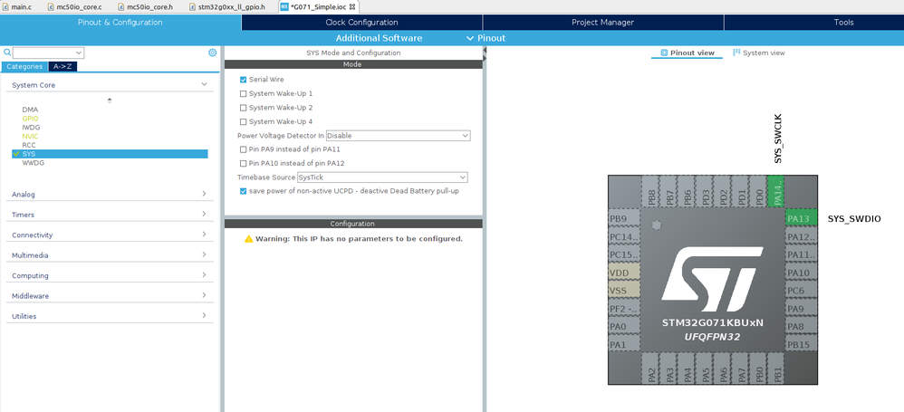

Last I generated a simple (KISS) project called just simple to test problem & share here: surprise :( ####@@@@@!!! :(v :thumbs_down:
No PA15 but PD0, NO PB4, NO PB5 Instead of them PD 2 PD2...
AAAAAARGH!!!! Another day and half lost across defective software ...

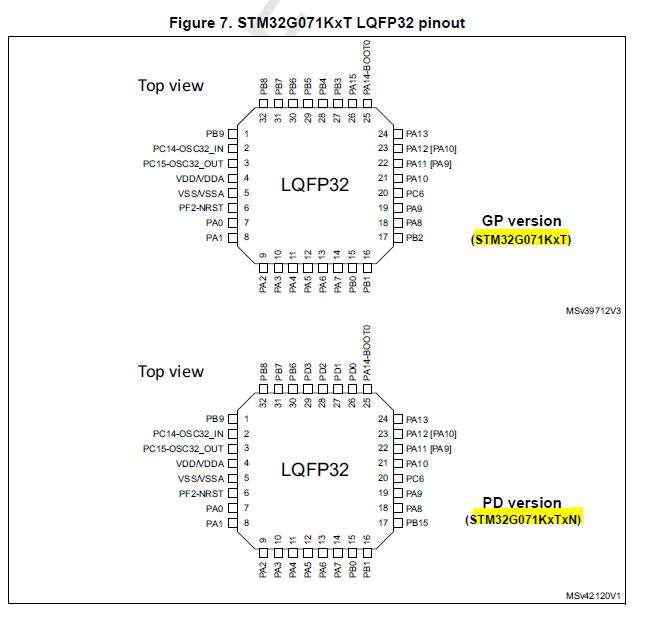

According to the screenshots attached you are using two different versions of STM32G071KxT LQFP32 MCUs: STM32G071KBUxN (PD version) and STM32G071K6Ux (GP version). Each version has its own pinouts.
So I don't think it is an IDE error.
Please refer to STM32G071x8/xB DS for further information (https://www.st.com/resource/en/datasheet/stm32g071c8.pdf).
