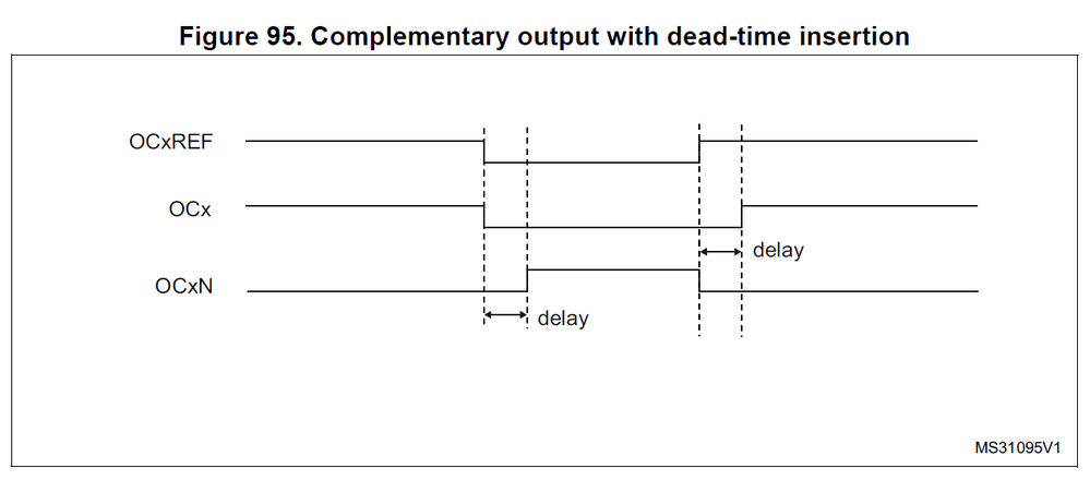

I​ have control H-bridge with 4 MOSFET up to 100KHz.
Will it possible to Generate PWM in Push Pull Mode with deadtime with STM32G0 MCU and CubeMx ?
Is there any ​PWM Fault pin for that ?

There is a break pin and channel. See the reference manual for the details.

The STM32G0 has dead time insertion on the advanced timers (TIM1).
Thanks @TDK​
Is there any ​PWM Fault pin/Shutdown for that ?

How to generate Push Pull Mode with  PWM Fault pin/Shutdown CubeMx for 2 channels with TIM1 ?
