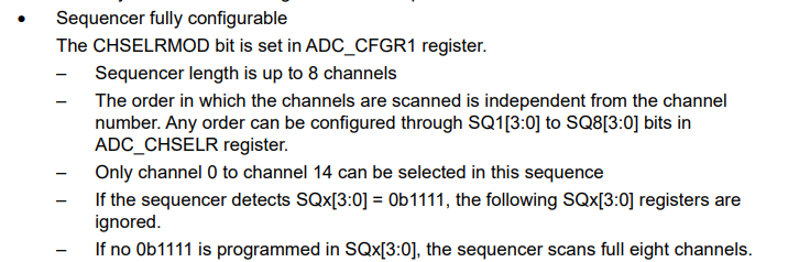

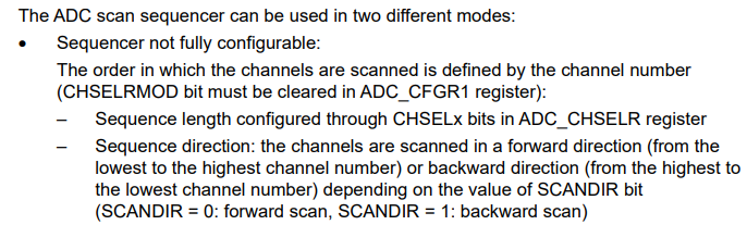

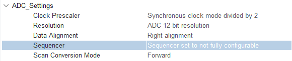

You are proberly still in normal mode and not in legacy mode.
If you configer the ADC to "not fully configurable" you can use ADC_IN15&16&17

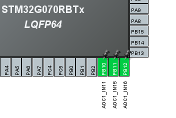

Chan.Calvin
Hi
Just open a new project with the STM32G070RB device selected.
click on PB10 to select ADC1_IN11 to turn green
click on PB11 to select ADC1_IN15, and PB12 to select ADC1_IN16 both turns yellow.
Here is the screenshots and ioc file in zip.
01 and 02 pictures shows the hovering at PB10 (green- ADC1_IN11 (IN_11)), and PB12 (yellow _ ADC1_IN16 (no mode)).
The centre panel-ADC mode and configuration, shows ADC configuration with IN15 to IN18 grey out ???

Chan.Calvin
Thank you for the reply, That seems to solve the problem. It is really hidden in the reference manual that is not easy to spot.

!!Source RM0454 section 14.3.8 page 284 and 285
--Not fully configurable--
Chan.Calvin
That is correct. Really need to look deep into the reference manual and need to understand what is it all about. Surely this should help other users as well.

Chan.Calvin
By the way, a newly created project should have the default of 0 for CHSELRMOD bit if not explicitly configured, which means the default is "Sequencer not fully configurable" and should have the green for both PB11 & PB12 though. But this is not the case.
