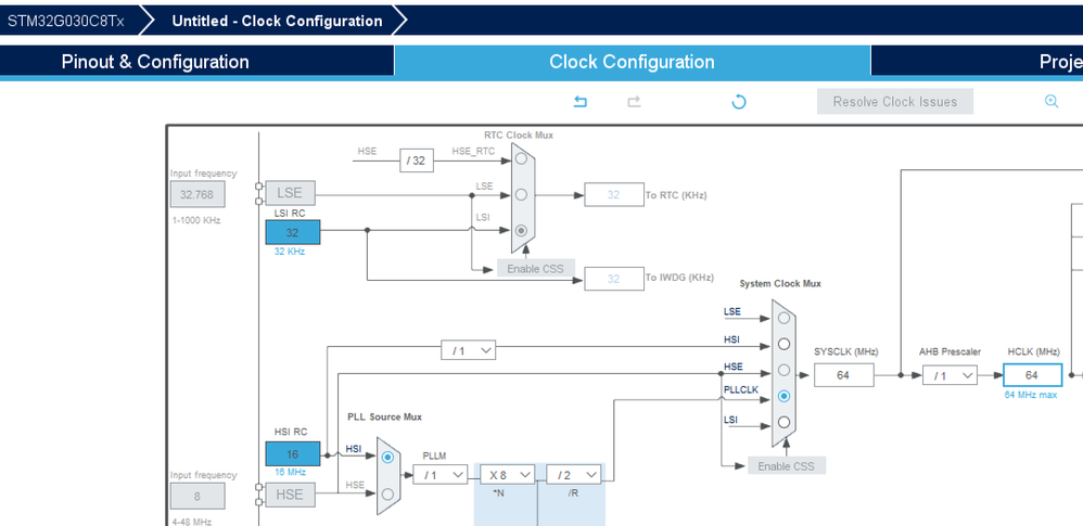

2: Cube MX cant enable 64Mhz on the clock config (max 48Mhz) a bug?

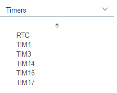

3:TIM15 can be enbled by CubeMX G030Cx but is not on G030Cx devices, bug in CubeMX?
Works fine for me.
I don't see a TIM15 for this chip.
Maybe update your software and make sure your project is using the chip you think it is.

Have the latest Cube MX 5.6.1 , it shows TIM15 but PLL have only div/mul stage
and 3 way mux and not as in your picture. However if i switch over to a G030K/071C
then i can set 64Mhz core clock and TIM15 vanish and can set the DMAMUX .
So something is weird with Cube MX and as usually with ST data sheets needs revisions, e.g picture on cpu says 56Mhz!

I selected STM32G030C8Tx on STM32CubeMX and try to check what is the issue, but didn't catch it, sorry.
Could you please explain more what is wrong from your point of view on documentation and STM32CubeMX?
Thanks.

Hi
CubeMX 5.6.1
STMCudeIDE 1.3.1 (CubeIDE 1.3.0 was not working properly.)
None of issue mentioned, work fine no trouble on DMAMux, PLL too.

Hi GBral, maybe your project was generated on early STMCUbe version supporting Gxxx series. Some bug where in place and migrating don't solve. New project must be generated on latest version to be sure of correct settings. I realized config file is a text file and if something is wrong there remain as is.
Early version was assigning just one pin of I2C, not sure but some issue where on processor selection too.
After a lot of time to understand what was wrong with Java got both stmcube and cubeide working fine. Overall feeling now is good.
