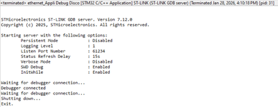

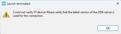

I’m working on an STM32H7S78‑DK project that uses FreeRTOS, with STM32CubeIDE v2.0.0 on Windows. The ST‑LINK debugger works normally as long as RTOS Proxy is disabled, but cannot be launched once I enable RTOS Proxy. Error message and Console prints as below:

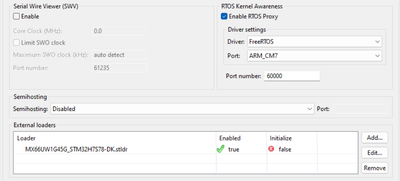

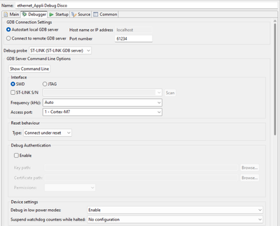

My debugger configuration:
