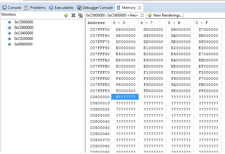

I'm facing the same problem with the memory access above 0xC080 0000:
https://community.st.com/s/question/0D53W00000NCIBNSA5/stm32f767-and-external-sdram-addressing-issue?t=1604783685617
The difference is, that I'm already using a 32bit variables to write and read from the SDRAM.
uint32_t RxBuffer[SDRAM_TEST_BUFFER_SIZE], TxBuffer[SDRAM_TEST_BUFFER_SIZE];
Do you have any hints what I can still check?

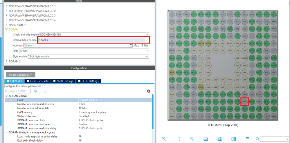

Hi FGeig.1 !
Yes, when I write data into the SDRAM, read out and compare, then I get a 1:1 match.
After attempt to write above 0xC080 0000 I get a HW fault.
Now I have tried to reduce the configuration to 2 banks and the result is the same:

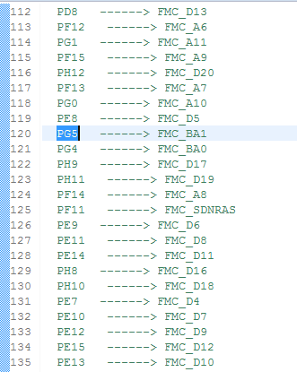

When do this, then the BA1 pin (PG5) is deconfigured in the pin overview:
In the configuration of the fmc.c I can see the bank pins:
  /* GPIO_InitStruct */
  GPIO_InitStruct.Pin = GPIO_PIN_15|GPIO_PIN_8|GPIO_PIN_1|GPIO_PIN_0
                          |GPIO_PIN_5|GPIO_PIN_4;
  GPIO_InitStruct.Speed = GPIO_SPEED_FREQ_VERY_HIGH;
  GPIO_InitStruct.Alternate = GPIO_AF12_FMC;
  HAL_GPIO_Init(GPIOG, &GPIO_InitStruct);
