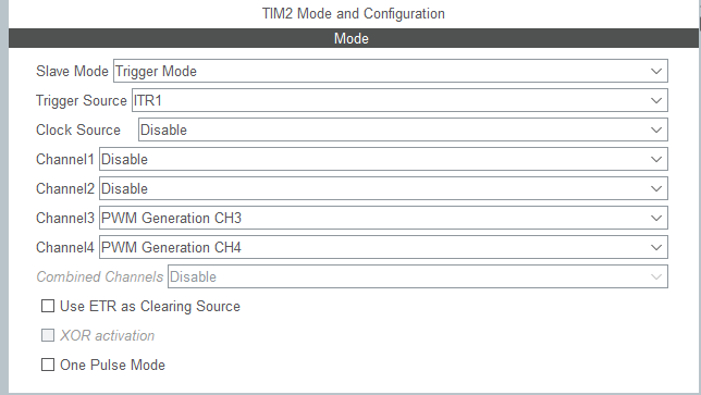

I try to synchronise 6 PWM outputs for an BLDC controller.
I use 3 timers :
0693W00000WHjN3QAL.pngMy target is STM32F446RET6 and I'm using STM32CubeIDE.
I read that I add to use master/slave mode. I'm not sure it is the best way, but I configured TIM2 (slave) as follow :

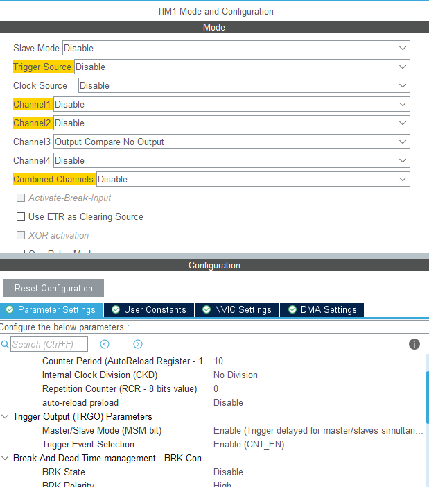

0693W00000WHjXRQA1.pngI chose TIM1 for my master timer :
For now, the PWM outputs don't start.
I think I'm missing something. For example I chose ITR1 but I can't find in datasheet where does it come from.

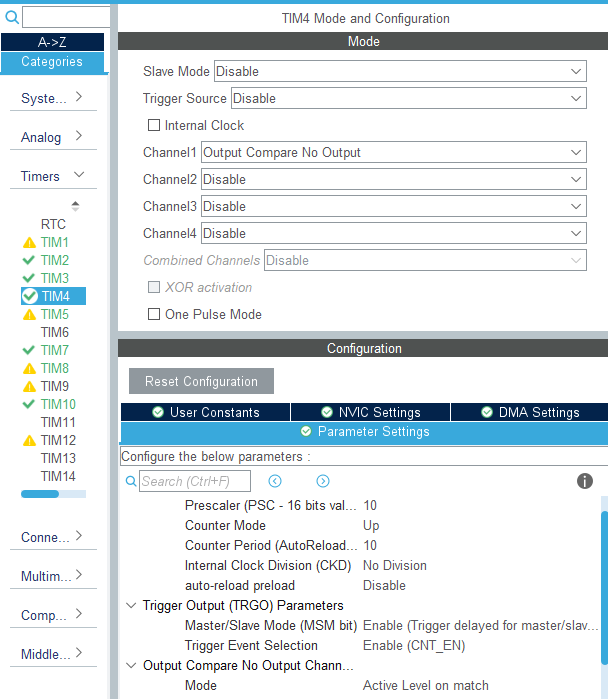

Thanks JW, it helped me. Now it is working only using CubeMX.
Here is the configuration of the master timer :

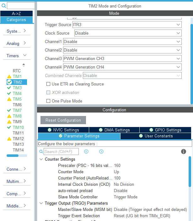

0693W00000WHr5GQAT.pngConfiguration of the slave timer :
And we have to start both timers :
 HAL_TIM_OC_Start(&htim4, TIM_CHANNEL_1); // master timer
 HAL_TIM_PWM_Start(&htim2, TIM_CHANNEL_4); // slave timer

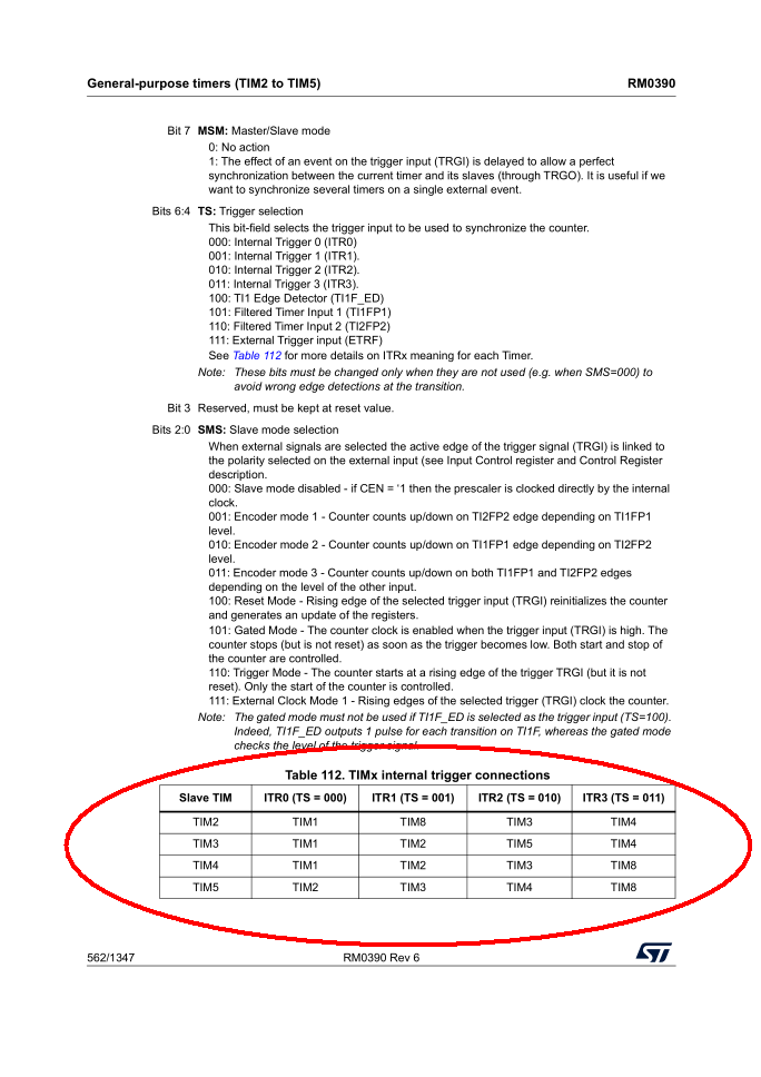

0693W00000WHjdeQAD.pngRead the TIM chapter in RM.
If clicking in CubeMX does not bring you success, ditch Cube and write your own program.
