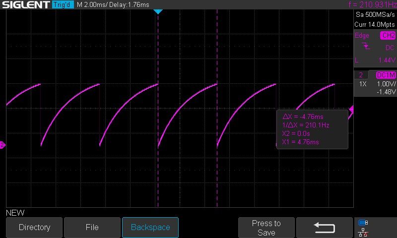

STM32F429ZIT6 STM32F429I-DISCO MB1075 B-01cycle NRST _ HELP. This is the NRST waveform.
BKond.1
CUBE_MX 6.8.0 Cube PACK 1.27.1 EMPTY project
BKond.1
Issue resolved. Vector table =)

Is this an ST board (NUCLEO, DISCO, etc.) or a custom board?
If a custom board, what is connected to the NRST pin? Show all power connections if you can. Check the supply voltages. Do you have enough bypass caps on ALL supply pins including VCAP1/2.
BKond.1
board STM32F429I-DISCO MB1075 B-01.The demo example works great. When generating a project in the CUBE_MX 6.8.0,pack 1.27.1 , a soft reset is raised cycle.I do not know what to do
Bob S
Positive the project is empty? No peripherals or GPIO defined? What clock source do you have selected? If HSE do you have the correct crystal frequency? No watchdog enabled? Read back the option bytes from the DISCO board.
BKond.1
from the periphery only GPIO. the SFTRSTF flag is constantly raised.
But a few lines on CMSIS work fine. after CUBE_MX, a permanent SFTRSTF. :sleepy_face:
Bob S
Software reset comes from setting the SYSRESETREQ bit in the CortexM4 AIR register. Somewhere is code that calls NVIC_SystemReset(), or does the equivalent.
So - break out your basic debugging skills. Set a breakpoint at main() and step through your code until it either magically reboots or you find the code that calls NVIC_SystemReset(). If your code doesn't even reach main, open the startup_stm32f427???.s file and set a breakpoint at the "Reset_Handler" able and step from there.

Debugged 100 times =)
With a debugger, the code goes through the steps every time, so it’s not very clear what the chip doesn’t like. I will search =)
USER_VECT_TAB_ADDRESS. just why system_stm32f4xx.c decided to do it this way, this is starting from the 1.26 package. And the same file on 407 works ok.
