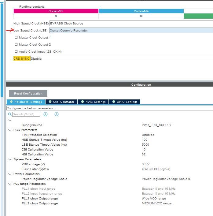

Hello, i have found some bugs

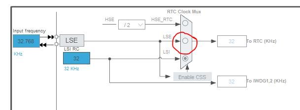

I can't select the external 32 khz osc .

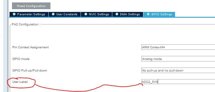

the input field of the User Label have some problems
edit this fields don't work properly
CTRL + c/v don’t work

Hi @Hans T​
So to conclude, for the first problem related to LSE activation : you need to Enable RTC if you want to change RTC Clock Mux.

Hi @Hans T​
For the LSE Problem : you need to Enable RTC in you want to change RTC Clock Mux.

‎2020-12-04 7:26 AM
->For the LSE Problem : you need to Enable RTC
yes, it works thanks

‎2020-12-04 9:18 AM
Enter User label in the Pinout view works good
only the UserLabel in the Configuration field is an problem

‎2020-12-14 2:29 AM
Hi @Hans T​
For the seconde one which is a problem with User Label, thanks for sharing your ioc file to reproduce the issue, you're right and it will be fixed.
