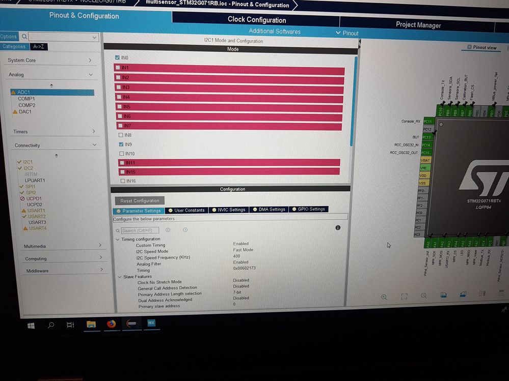

During the ADC configuration for STM32G071RB in CubeMX, the program hangs. This is only for ADC. I checked it on two computers.

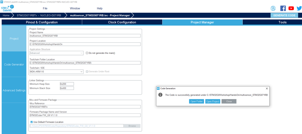

wuio
Dvorak.Peter Can you check this file? The pure project does not actually hang and on this file it does. I have here a lot of things set up and I do not know which one is a problem

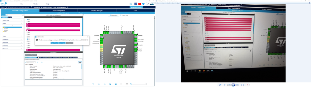

wuio
0690X0000088XwuQAE.jpgThe cube is a evident problem, You can see when you turn something into a problem with ADC. See I have ADC turned on and the configuration from I2C is displayed

Works for me.

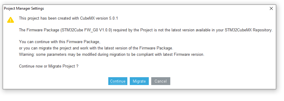

EKrum
I am also having this issue in CubeMX v5.1.0. When I click on the ADC configuration in the left panel, CubeMX freezes. I reinstalled version 5.0.1 and I do not have the problem. I do have the latest version of Java 8 for mac installed, so I am not sure if java is causing the issue, perhaps it is a bug in CubeMX? I have specifically been attempting to create a default project for the L496 Discovery board.
