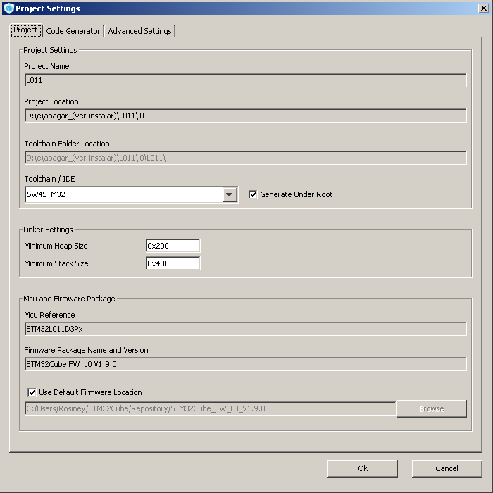

I am wroking on a project using two microcontrollers a STM32F412 and a STM32L011 (8K flash, 2k RAM) .The STM32L011 is used as RTC to manage the power comsumption of the STM32F412.
I used STM32CubeMx to generate the code to set the peripherics that I use within the L011 (I2C, RTC, RCC). The problem is the size of the generated code once compiled is bigger than the 8k available inside the flash of the L011.
I only compile the genretaded code without writting a line of code.!
How could be possible to get a bigger code than the place to stored it for a defined STM32?
I think I did something wrong but I can find what is wrong.
Someone could provide me any ideas to resolve this situation. (i can not change the micro)
You will find in attachment the .ioc file. The genrated code from STM32Cube Mx is trasnfered on a Eclipse platform
and is used GNU ARM tools.
.Thanks in advance for your help

Try changing the values using ''STM32CubeMx'':
The default setting is:
_Min_Heap_Size = 0x200;
_Min_Stack_Size = 0x400;
or 1536 bytes reserved. (75% of 2048).
reduce to:
_Min_Heap_Size = 0x100;
_Min_Stack_Size = 0x200;
or
_Min_Heap_Size = 0x000;
‎2018-01-12 1:02 PM
I guess care should be taken when playing with stack and the heap. Can reduce the values of these based on the app requirements. e.g. if you allocate an array of 0x200 bytes inside a function (main() is function as well) your app probably crashes as the stack is used by the array.... Also when you use malloc() or dynamic array you can run into trouble with heap when underestimated. Also need to take care when using foreign libs when we do not know what are exact requirements.
