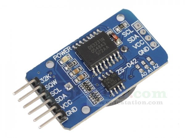

Posted on March 02, 2017 at 10:20
Your eeprom is probably not powered, or SDA/SCL crossed or WP pin level is wrong, or bad soldering. Should be typically something obviously simple that is missed. Take a step back and contemplate the board.
Nicolas Felipe
Posted on March 03, 2017 at 05:21
its not my friend , when switched to the arduino it reads it ok.
its the DS3231 AT24C32 IIC Module (this one
http://www.icstation.com/images/big/productimages/2416/2416.JPG
can read the DS3231 rtc at the 0xD0 address with :
I2C_ReadBuffer(hi2c1,(uint16_t)0xD0,7); // function writes to
aTxBuffer
year = aTxBuffer[6];
year = RTC_ConvertFromDec(year);
month = aTxBuffer[5];
month = RTC_ConvertFromDec(month);
date = aTxBuffer[4];
date = RTC_ConvertFromDec(date);
day = aTxBuffer[3];
day = RTC_ConvertFromDec(day);
but cant get or write any data to the ATC32 at the 0x57 with the Hall Library.
