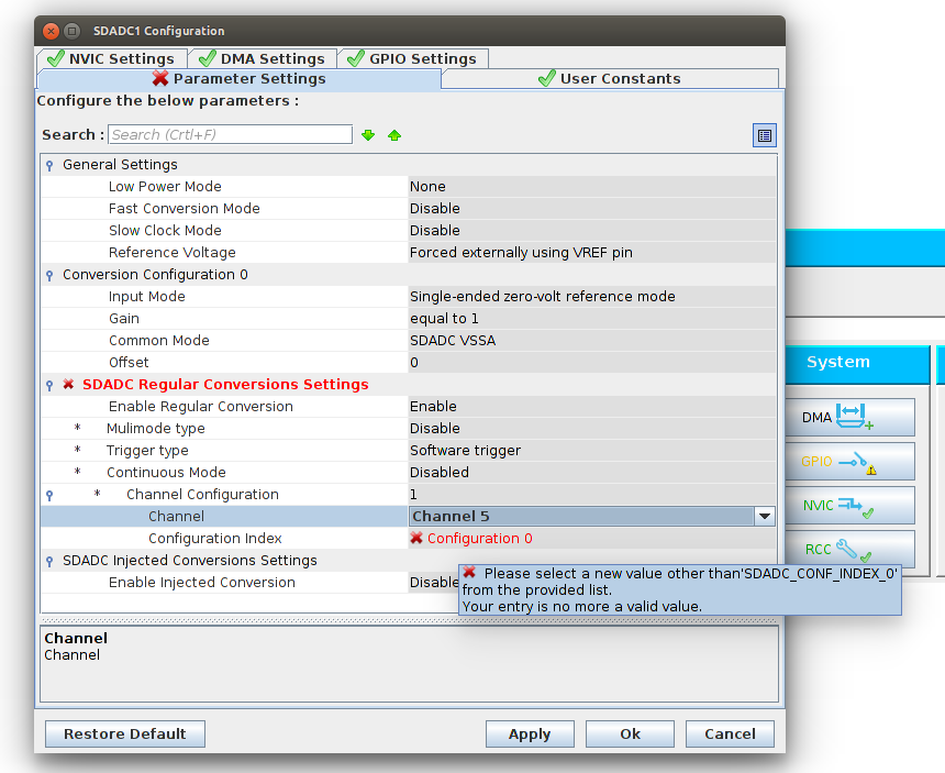

I'm using using STM32cubeMX to generate the init code for an STM32373C-EVAL board and have found this problem setting up the SDADC (see picture).
Basically, I can't set 'Configuration index' to anything other than the default which it tells me is not valid.
If I ignore all the error messages and generate the code anyway, it does actually generate good code which works.
I'm just learning this tool so thought I'd ask if I am doing anything wrong...
It's cube version 4.18 on Ubuntu linux.
Thanks !

Darren Legge
Posted on December 21, 2016 at 17:06
Thanks. I think it was actually because I had selected 'single ended' rather than 'single ended zero-reference' on the 'Pinout' tab. Then in the screen above, 'single ended zero volt reference mode' was selected (which needed to be single ended offset mode to match). Probably...

Posted on May 02, 2017 at 16:50
Hello
Legge.Darren
Thanks for reporting this issue.
We have just fixed and it will be delivered in the next CubeMX release (4.21) that will come soon!
