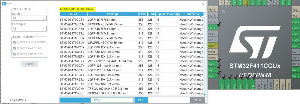

I want to convert my project from using an STM32G491xE to an STM32G431xB.
To my understanding, the only way to switch between microcontrollers is using the STM32CubeMx "List Pinout Compatibility" feature.
The problem: this functionality does not work on the STM32CubeMx v6.5.0 release.
Not only does it display those weird graphical glitches (see .avi), but it prevents me from doing any conversion (the convert button is never enabled).
This problem has been reproduced with another computer with a fresh install of CubeMx v6.5.0.
The problem has not been seen on CubeMx v6.4.0.
In the meantime, what is the workaround for this?
Is there a manual way to convert a CubeMx v6.5.0 project into a CubeMx v6.4.0 project?
Thanks

Hello @GBert.2​,
Thank you for your feedback,
This is a known issue and has already been reported internally. It will be fixed as soon as possible.
Internal ticket number: 125055 (This is an internal tracking number and is not accessible or usable by customers).
In the meantime, I suggest to reconfigure your MX project with the new device.

0693W00000NskL5QAJ.jpgAfter a month it is still not fixed.
The processors are extremely difficult to obtain and then this feature fails. The tool finds just over half a million chips in one day. I'm seriously wondering if ST is actually interested in the whole thing.

Aziz BRIGUI
Aziz BRIGUIBest answer
June 29, 2022
Hello @GBert.2​ ,
Issue fixed in STM32CubeMX latest release.
V6.6.0 is now available under this Link.
Thank you for your contribution.
Best regards,
Aziz.
