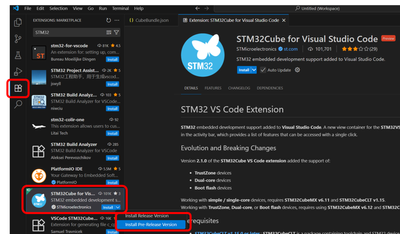

To install pre-release follow these steps:
1- if you are a new user
2- already a user of our extension
