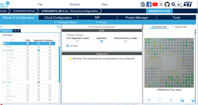

Hi everyone,
 can anyone provide total DCMIPP camera interface STM32CubeMX    .ioc file therefore I can create a project and My applications. Please help me to implement the B-CAMS-IMX camera.
I also try with BSP drivers that are available in STM32N6570_discovery_bus.c and .h , STM32N6570_discovery.c and .h file but in IMX335.c file I am unable to read device ID properly.
So, please provide proper DCMIPP camera interface STM32CubeMX .ioc
Thankyou.

Thank you for responding,
 I have tried with them but there is no .ioc file to add another peripherals and also I enabled DCMIPP drivers and LTDC drivers from STM32CubeMX but it is not working. So, please if any .ioc of cubemx or any document to enable camera provide here. It will very helpful to me.
Could you please refer to this Application Note: https://www.st.com/resource/en/application_note/an5020-digital-camera-interface-dcmi-on-stm32-mcus-stmicroelectronics.pdf , where you can find a dedicated section 8.3 DCMI examples based on STM32CubeMX which describes STM32CubeMX settings for DCMI.
This should help you to create your project.

when I testing the DCMIPP interface in external project the ID that I receiving is not matching to IMX335_CHIP_ID and IMX335_CHIP_ID mentioned as 0x00. But I'm not receiving that value so that so, the code is entering into Error_Handler().  and also the variable NbMainFrames  is not incrementing I cannot find the issue in that. Could please provide the IMX335 camera sensor datasheet or document so I can go through it. Thank you.

Thank you for replay,
I have to implement the DCMIPP interface without using the BSP drivers. I am only using IMX335_reg.c,imx335_reg.h and imx335.c , imx335.h files and I am enabled DCMIPP interface in STM32CubeMX in CSI mode but when I enabling CSI it showing warning: This peripheral has no parameters to be configured.
I have attached the .ioc file of CSI interface. Is it possible to do without using BSP drivers. help me to complete the DCMIPP interface in STM32N6570-DK board. Thank you.
I am also attaching the DCMIPP configuration below please go through it and help me to proper configurations od DCMIPP interface in ioc file. Thank you.
