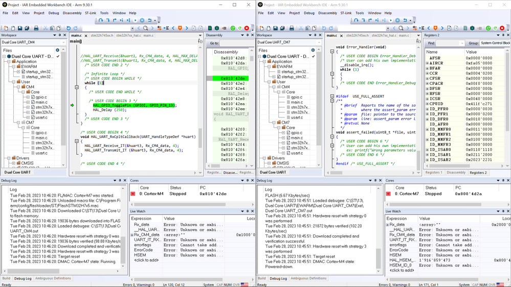

0693W00000aHIfoQAG.bmpHai, Fxxx :) My name is Uwe, I'm from Germany and I work as a freelancer for INOCEL, Saint Égrève.
The code below was generated directly from the STM32CubeMX for the M4 (remarks removed).
int main(void)
__HAL_RCC_HSEM_CLK_ENABLE();
 HAL_HSEM_ActivateNotification(__HAL_HSEM_SEMID_TO_MASK(HSEM_ID_0));
 HAL_PWREx_ClearPendingEvent();
 HAL_PWREx_EnterSTOPMode(PWR_MAINREGULATOR_ON, PWR_STOPENTRY_WFE, PWR_D2_DOMAIN);
 __HAL_HSEM_CLEAR_FLAG(__HAL_HSEM_SEMID_TO_MASK(HSEM_ID_0));
If I set a breakpoint @ EnterStopMode..., and resume it afterwards, it works, but the M7 doesn't run.
If I just flash it and switch the board Off and On again, it also works for both kernels.
Within the IAR and without a breakpoint, I got what can be seen in the attachement.
Regards, YouB

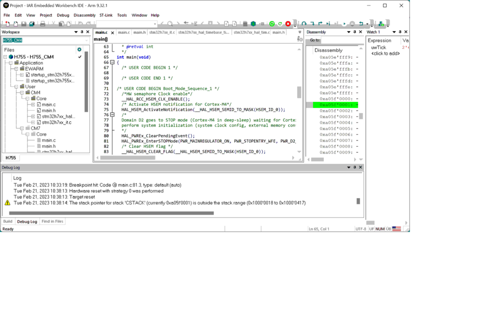

FBL
Hi Uwe and welcome to ST Community :D
When you run the program without a breakpoint, the M4 and M7 cores may not be synchronized properly before entering STOP mode, which could cause issues when resuming normal operation.
Adding synchronization barrier in this case before entering stop mode.
__DSB();
When you switch off and on the board, it gives the system enough time to reset and synchronize the access to shared resources, which could explain why it works for both kernels.
Also, try to increase the stack size in the linker configuration.
Hope this helps!

FBL
Note that, CM4 program will be copied by CM7 program. So, after booting sequence of each core, you can add breakpoint and debug your code. Otherwise, a warning of stack outside the range is fired since the memory is corrupted. After that, the debug fails.
Here is an example to debug both cores. Make sure to enable multicore debugging/shared mode in STLink configuration.
0693W00000aHpVSQA0.pngHope this helps understand the issue!
