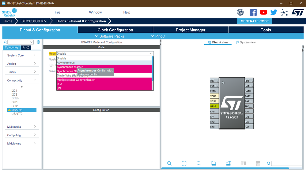

I would like to report 2 bugs.
  1. I created a blank new project for STM32G030F6P6. When I try to enable USART1, it says "Unknown conflict". See the attached screenshot.

a.gajdacs
a.gajdacsAuthor
May 22, 2022 9:42 AM UTC
Hi Sara,
Sorry for the late reply.
The issue No. 1 seems to be resolved now, it must have been a transient flaw.
