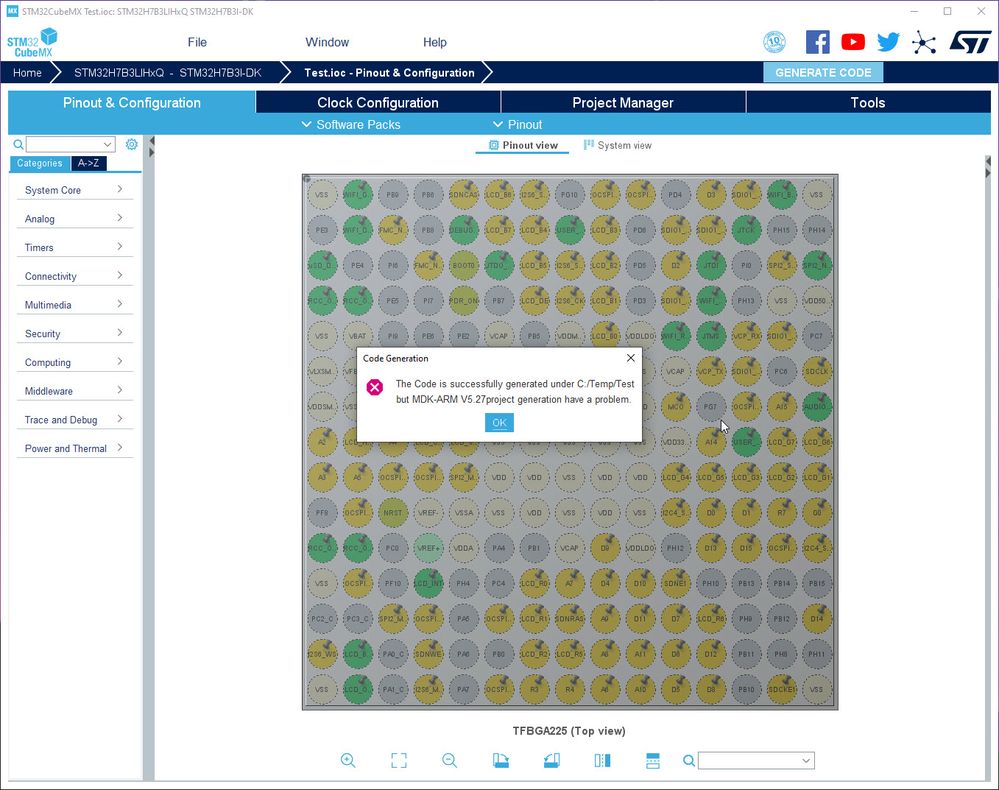

Windows 10 64bit - STM32CubeMX 6.0.1 - STM32H7B3LIHxQ MCU
Attempting to generate a fresh project and get the below error. Any thoughts on how to resolve the issue? project file attached. Thanks!

Good, I found your issue !
STM32CubeMX is pointing to JAVA 13 :(
below and extract of the log:
2020-10-05 09:18:38,387 [INFO] MicroXplorer:564 - Detected Java Version = 13.0.1
As described in the STM32CubeMX User Manuel UM1718.pdf, CubeMX is not validated with JAVA 13.
Can you clean your environment by installing only JAVA8 and updating your Java path is configured?

‎2020-10-05 9:00 AM
I removed the JDK v13.0.1, restarted, deleted all non necessary files in that directory and project generation is now successful!
Thank you for your help!
