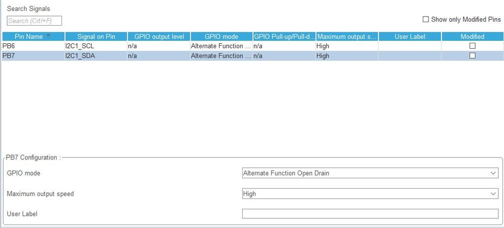

I'm trying to imitate an I2C solution. I'm using STM32F100RB.
When selecting I2C ->

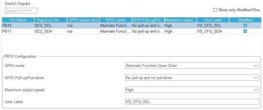

In the example, they have these GPIO settings for I2C pins:
Note the GPIO Pull-up/Pull-down option:
Here is mine:
The CUBE version is identical.
The I2C configuration is identical.
What could be the reason?

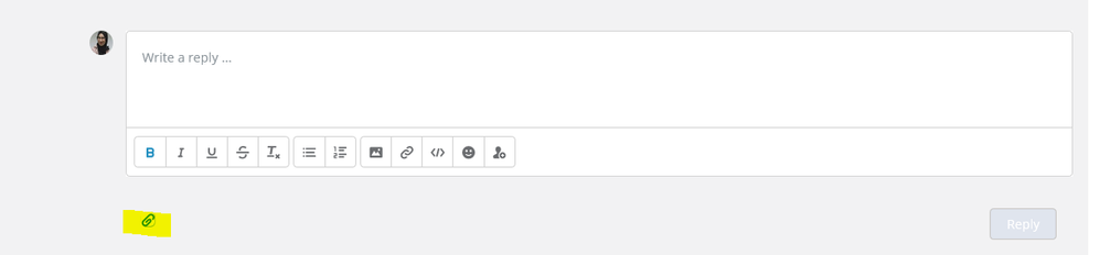

Khouloud ZEMMELI
May 30, 2019
@ISeed​ select this Icon then ​upload the ioc exemple file.
Regards,
Khouloud.
S.Ma
Principal
May 30, 2019
In any case, beyond the tools, nothing prevents you moving forward by programming the GPIO->PUPD registers directly.
2 lines of code, how long would it take to make it happen?

S.Ma
Principal
May 30, 2019
open stm32l4xx_hal_gpio.c and dig in:
 /* Activate the Pull-up or Pull down resistor for the current IO */
 temp = GPIOx->PUPDR;
 temp &= ~(GPIO_PUPDR_PUPD0 << (position * 2));
 temp |= ((GPIO_Init->Pull) << (position * 2));
 GPIOx->PUPDR = temp;
Want a pullup on PB3?
GPIOB->PUDR &= ~(0x03<<(3*2));
GPIOB->PUDR |= (0x01<<(3*2));
Want a pulldown on PB3?
GPIOB->PUDR |= (0x02<<(3*2));
Done, reading the ref man, 3 minutes, coding 2 minutes.
Brian D
August 23, 2022
But this workaround is not a good solution, as the user codes will be wiped off whenever the IOC is compiled. The pull up done in CubeMX is a better choice.
Brian
alister
Senior III
August 24, 2022
It's a workaround, but that's ok. If your work's important, version-control it. And after any cube-change just revert any of its changes you don't want
