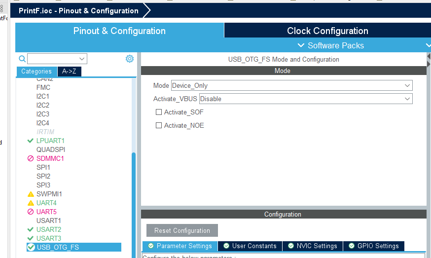

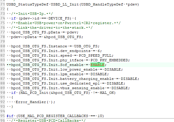

USB_OTG_FS: In one of two projects unselecting "Activate_SOF" in the .ioc environment doesn't disable its entry in the code! Error of the IDE or is there something else keeping the SOF enabled? As said, in another project it works a as expected.

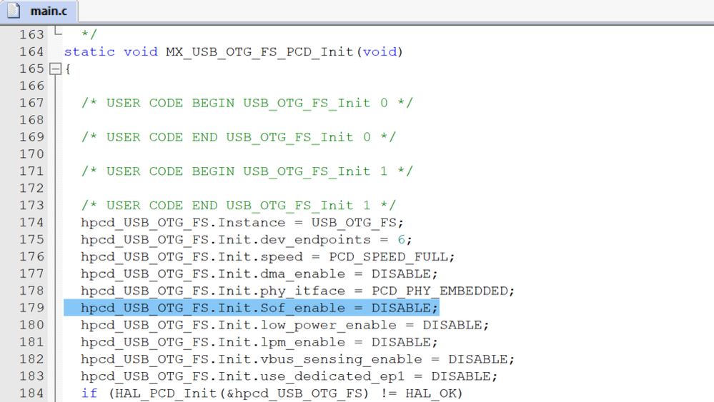

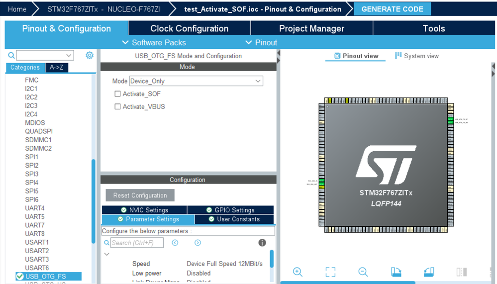

I reproduced your configuration using stm32cubeMx 6.6.1 and Nucleo-F767ZI
I kept SOF disabled then I generated the code using
stm32cube IDE and also keil I found that is working as expected
could you please give me more details about your version of stm32cubeMx and your SOC

NRoth.1
NUCLEO-L4A6ZG
STM32CubeIDE
Version: 1.10.1
Build: 12716_20220707_0928 (UTC)
STMicroelectronics STM32CubeMX
6.6.1.202207061420
com.st.stm32cube.common.feature.mx
NRoth.1
As mentioned already, it is probably not easy to reproduce it, as I have a more or less exact copy of that project in which it works. (The one in which it works is setup as C++, but I doupt that has anything to do with this is the issue, but could be wrong).

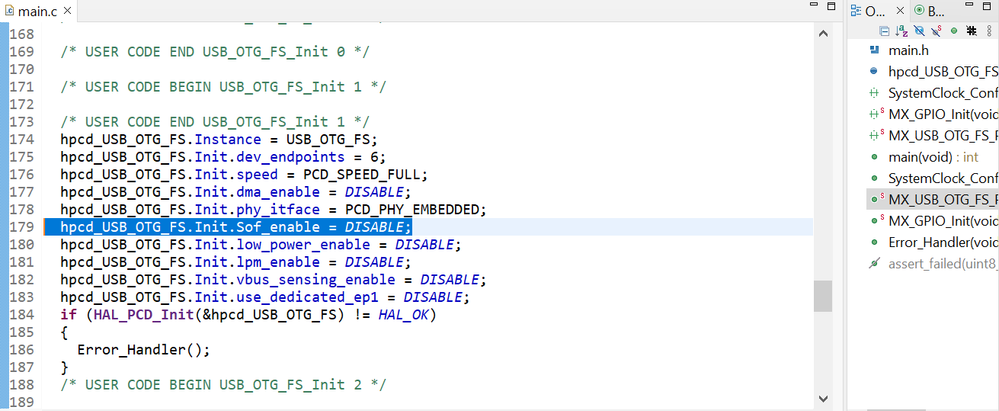

Hi @NRoth.1
I used your stm32cubeIDE version 1.10.1 and it works just fine
0693W00000QOINeQAP.pngGhofrane
