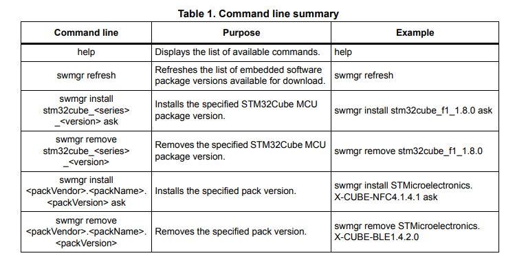

‎2023-05-05 2:50 AM - edited ‎2023-11-20 6:23 AM
Look at example in manual:
Use:
swmgr install stm32cube_g0_1.6.0 ask
without "FW" and without "V"
Use:
