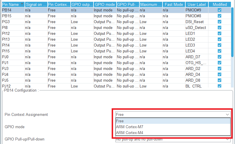

I start from CubeMX and open the project using CubeIDE with CubeMX version 6.1 and CudeIDE 1.5 and still get pretty much incomplete Init of GPIO when I set all defaults on STM32H747-DISCO
https://community.st.com/s/question/0D53W00000NUOGLSA5/cubemx-gpio-not-initialized-in-stm32h747disco
victagayun
Senior III
January 10, 2021
Sorry, I did not explore fully the GPIO in CubeMX for dual core like the H747.
You may need to assign which core will need to init it.
